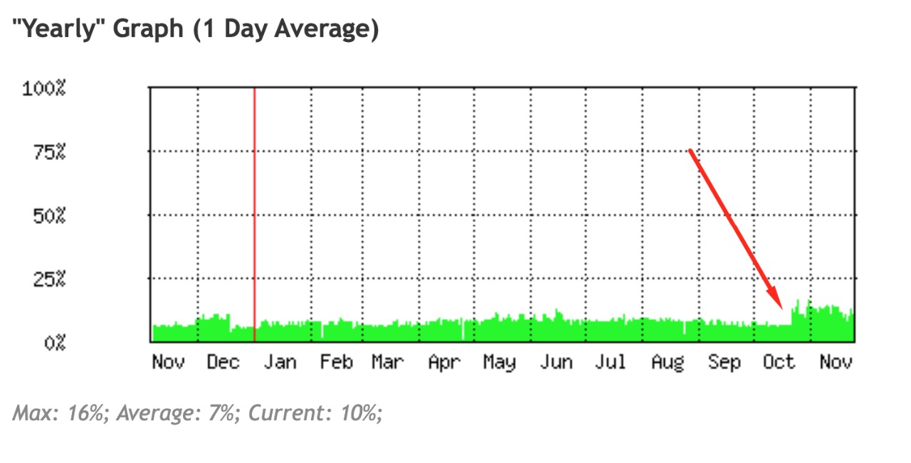

I think may be this problem started 1 month and a half ago when I changed the PPP Secrets to migrate from Public Static IP to Private Static with IPV6 Dual Stack.
My CPU Changed a little bit from that point, but anyway i wonder if the using of netmap (or the increasing CPU usage) could be related with these massive randomly dissconections.
CPU Usage
