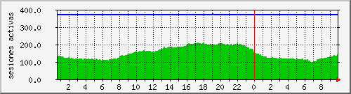

My setup
Ros: v3.11
Intel Pentium Dual Core: 3000 Mhz (set multi-cpu =YES)
RAM= 1Gb
PPPoE Secrets = 372.
Licencie = Level 5
Max simultaneously PPPOE users = about 211
I’ve not major problems. Everything is OK, but sometimes
%CPU overhead (each 2 o 3 days), and PPPoE server begins
to disconnect users or get random fails (but no Ros CRASH).
I restart ROS when this happens, and everything is OK for
2 or 3 days.
I’m not using RADIUS over my PPPoE server, but I want to
use FREE RADIUS soon!
best regards
andres.
