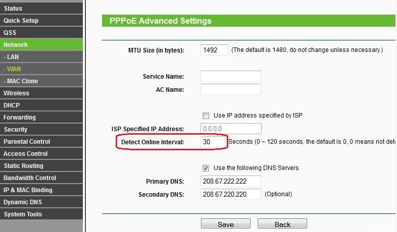

I just recently got into installing RouterOS v5.0 as a VM inside vmware esxi4.1u1 . Everything is fine but my pppoe connection disconnects every 7 to 8 minutes . Upon further observation, it shows that the ISP that I am connecting to requires the client to send out a LCP/LQR in 30 seconds interval in order to keep the connection alive. Are there any options under RouterOS that I can do to cater for this configuration ? :frowning:

What is your picture showing? A config page for another router?
I know there are keep-alive settings in the pppoe profile limits tab, ppp-profiles. That may help you.
yes its from another router.. just showing it because the ISP wants me to have this option enabled :confused:
Yeah i think thats the keepalive timer in the pppoe profiles there. its blank by default.
ok thanks for the heads up :slight_smile: i’ll try and see if it helps
That setting in your screenshot is not what you are looking for. That is for “connect on demand”.
