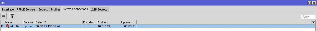

Where can I see if the right rate limits where correctly applied? Look at the Server’s active connection there is no information.
It was accepted a user from out of the pppoe radius group to login as a profile, is that correct? Or is a problem with my configuration?

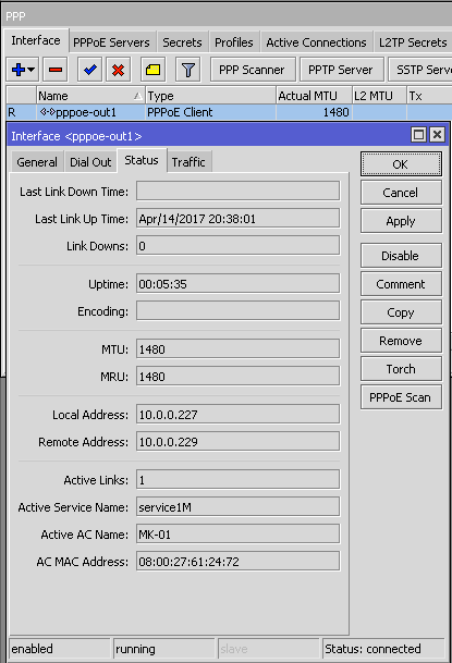

Looking at the pppoe mikrotik client’s status information about the established connection there is always the same information about the Active Service Name.
It doesn’t matter it the profile is configured locally in mikrotik server or using freeradius information. It is always the same.
So where does it say what was the implemented rate limit, since the Active Service Name is not reliable?
