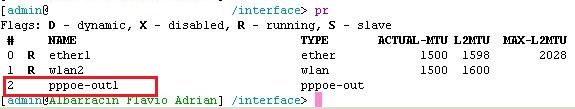

Hello, i’m posting because i have a pppoe problem in my network
some clients mikrotiks cpe doesn’t establish pppoe session
the interface is not runnig until the client disconnect from 220v and then connect again.

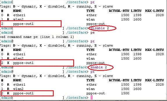

or entering to cpe in layer2 mac telnet from the ap and disable pppoe-client interface and enabling again.
