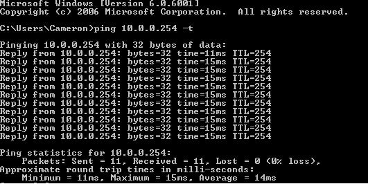

The problem I can see is all PPPOE connection the latency jumps to 15ms on the first hop, the network is all cabled no wireless If I disconnect the pppoe session and ping the same ip its sub 1ms.

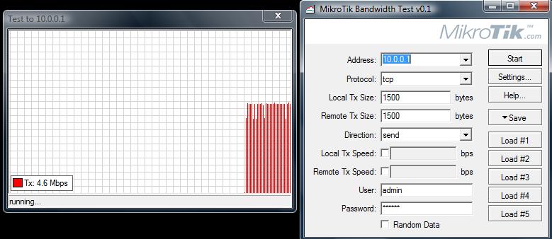

{EDIT} Forgot to also add the Upstream speed is capped at 4.6mbps for some reason while the downstream hits the CPU limit on the RB450 at 26mbps - :S any ideas this has me stumped I am using 3.23 and does this on v4 beta.

This is “the OLD” windows problem. Sometime it is 1ms and sometime it is 15ms.
If you mean for relation from RB to RB or RB to Mikrotik it should not heppend.
Just RB or Mikrotik x86 to Windows gives 1,15ms bug.
That is also sitation in case of
Cisco to Windows, you will also have the same problem,
so we can assume it is normal : )

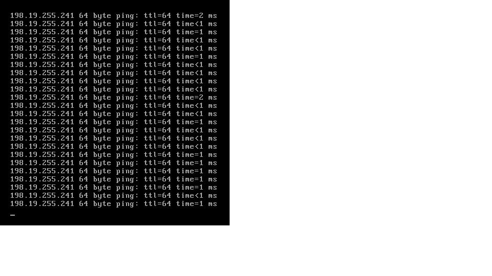

Yep. Definately doesn’t happen if you ping from the RB or from a linux system…

What is annoying me is the UPLOAD speed… its capped/chaped to 4.6mbps downstream is fine at 26mbps… should be alot more but hits the 100% CPU

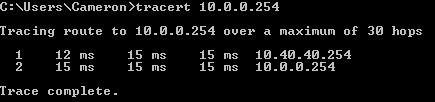

Below is a screenshot of PING and Trace first hop in the pppoe server second hop is my cisco 877
the 15ms doesnt really bother me its the upload speed thats annoying.. is there a way to fix this?
