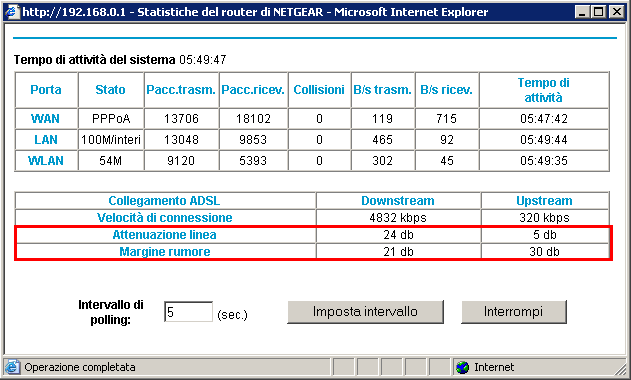

Hi, I have the RB951G-2HnD and I have connected to a modem in PPPoE.
This is my question, where do I find the data of ADSL?
My old Netgear router had this screen (look at the attached file).
Thanks!!
Sorry for my english..
Thanks!!
The xDSL information would come from the xDSL router not the RouterBoard since the modem is still handling that link. Presumably your modem is in bridge mode and you are using PPPoE on the RouterBoard. Most xDSL modems will still respond to an IP number while in bridge mode. You can add a suitable IP to your RouterBoard interface and access the xDSL modem’s info page that way.
Yes it’s correct!!! I think the IP (modem in bridge mode) is 192.168.0.1 but I have 192.168.88.0.
How do i communicate two different IP?
Thanks.
Do you have the xDSL modem connected to a “WAN” port on your RouterBoard - i.e. a different port from the LAN and its 192.168.88.0/24 addresses?
If you do you can simply add an address on the 192.168.0.0/24 network - e.g. 192.168.0.2 with a 255.255.255.0 netmask to that WAN interface. You may also have to masquerade the traffic leaving on the WAN interface because the xDSL modem will not have a default route back to you.
