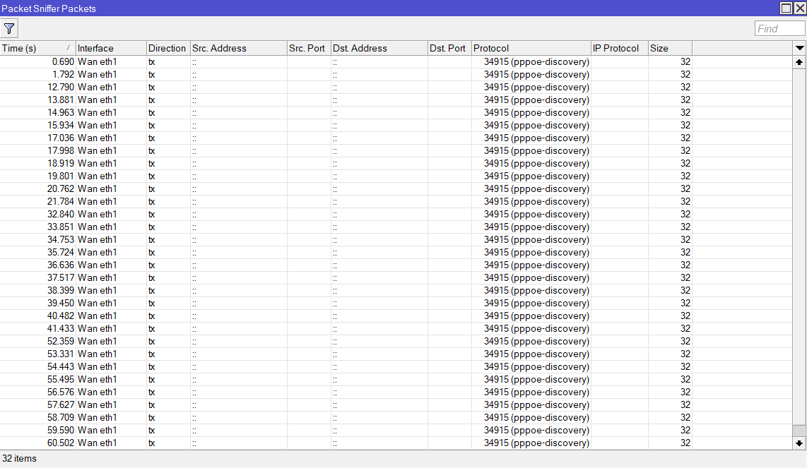

pppoe not working? Port forwarding in turn not working.
I use the Hex S as my router for my home internet. My isp is a wisp. I connect over pppoe, but things don’t seem right. In the interfaces, pppoe connection shows disconnected. I know I am somehow connected since internet works (mostly). The pppoe connection shows as no data going through it, all data goes through wan ethernet 1. Despite that trying to port forward through nat doesn’t work using wan ethernet 1 or the pppoe as the interface. This also means upnp doesn’t work either. Although internet works, devices seem to lose connection and have a hard time connecting randomly.
Here is the log

The log only shows that PPPoE client doesn’t get any answer to its session setup attempts. No idea about why’s that … so why don’t you show the configuration (execute /export hide-sensitive in terminal window and copy-paste output) and write more about how WAN setup is supposed to look like? I.e. you’re mentioning WISP, yet you’re using ether1 (wired) interface as WAN interface. So where exactly does the w (wireless) part come into the play?
Thank you for the reply. The setup is: [wisp tower (cambium)] - - - wireless- - - - - - [cambiums pmp450 (poe)] __cambium poe injectorethernet wired to hex s___DAC wired to CRS326
Here is the export:

So here is what came of it:
/tool sniffer quick interface=“Wan eth1” mac-protocol=pppoe,pppoe-discover produced this
