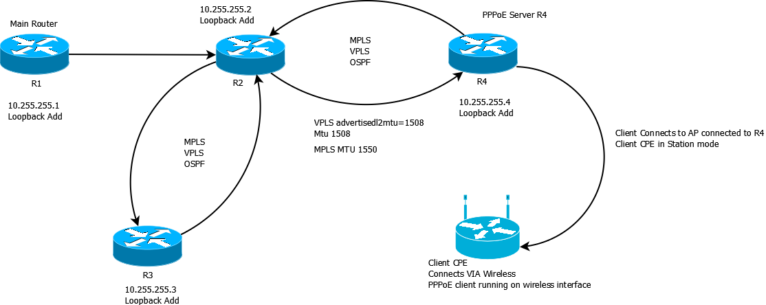

Can you provide a diagram of network, note on drawing where client is and where data is that he is downloading?
Just want to see where the possible problem areas might be
Ok see image of network, R4 is router that client is connected to that is having the speed issues

Majority of problems experienced with MPLS, etc is usually MTU related, but what I would suggest is go and have a cup of coffee with the client, then test from his connection and capture / sniff some packets to see if any excessive fragmentation occurs, etc. and take it from there
