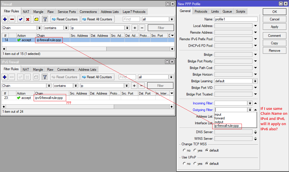

I believe that the subject and screenshot are pretty self-explanatory…
But:
Considering a PPPoE BNG scenario, and that I need to set and Incoming from customer, on dual stack!
Using /ppp/profile/add incoming-filter=, and if I create a chain with same name on IPv4 and IPv6, will it filter on IPv6 also?
I created some dummy chains with different names on IPv4 and IPv6 firewall rules.
And, as can be seen on screenshot, on the suggested itens of the incoming-filter and outgoing-filter it does not show the IPv6 chain name.

Thank you for your reply @yuripg1!
But there are two main intentions with the use of incoming-filter and outgoing-filter:
  • To be able to selectively apply, by user group to be defined by Radius-Server, different types of filtering for different types of subscribers.
  • For example: “Standard” subscribers normally have traffic blocked to port TCP/25, and clients that operate e-mail servers need this traffic open.
  • To reduce the size of lookups in tables as much as possible to reduce the consumption of computational resources of the equipment.
  • And this is where I believe your suggestion is not so appropriate, although it technically works.
    • Imagine a B-RAS with 1500-2000 subscribers. In practice, we would have 3 or 4 interface-lists that would have many items to be scanned and each packet that enters or leaves for all subscribers. In scale, this makes a lot of difference.
    • On the other hand, by creating a dedicated Chain for each type of subscriber, only the packets entering (or leaving) for that subscriber would be specifically treated in that specific chain.
From what I could find out, this feature works with IPv4.
But like almost everything in the MikroTik world, IPv6 was left aside…
I just wanted to confirm with other colleagues that this feature does not work, so I could think about opening a ticket.
