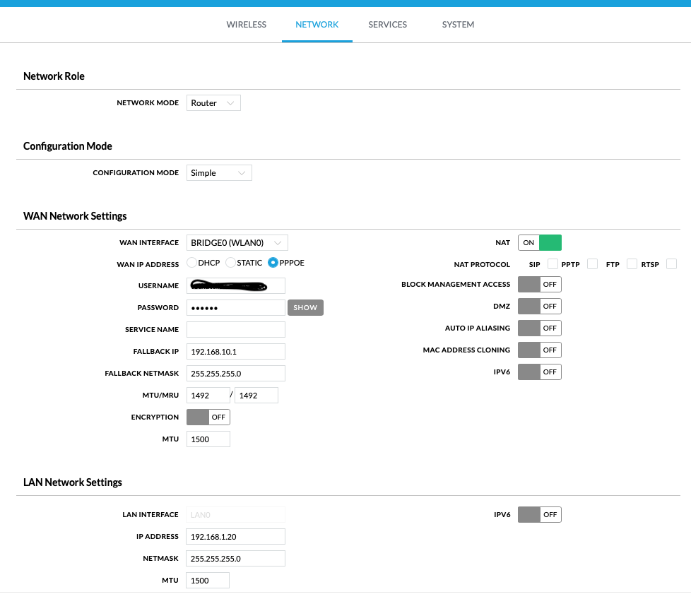

UBNT settings attached, maybe contains extra info :slight_smile:
This is the pppoe client on wlan interface.
