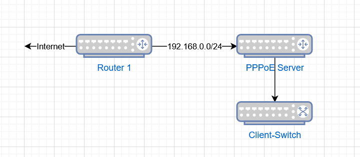

i have the following setup:
Router 1: WAN with Public IP
LAN 192.168.0.1/24
I want to create a PPPoE Server with the following interfaces:
Eth1: Connection to Router 1
Eth2: PPPoE Server
The PPPoE server should give static ip-adresses to the clients. For example client1 192.168.0.101 and should be bridged to eth1 if connected.
Does anyone know, how to configure the mikrotik for such a purpose?
I am struggling with giving routes to clients and how to bridge with another interface.
Thank you for your help

You cannot bridge PPPoE to another interface as the client-server connection is IP / layer 3, not ethernet / layer 2.
To communicate with Router1 your PPPoE server ether1 requires an IP address, and you can use proxy ARP so the Mikrotik answers ARP requests for any PPPoE client addresses overlapping with the 192.168.0.0/24 subnet.
Thank you, proxy-arp was the solution.
