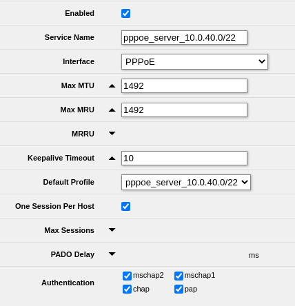

I’m looking for help on the forum for a small problem that I can not solve.
I have a PPPoE server configured with Mikrotik which works fine with all Ubiquity devices, PPPoE connects and everything works.
I tested a LTU Base Station, with the latest firmware update.
From here I started having these messages on the Mikrotik Log however the PPPoE connects even if with bad Troughput.
Example:
pppoe, ppp, info : terminating…
pppoe, ppp, info, account xxxx logged out
pppoe, ppp, info : disconnected
pppoe, info PPPoE connection established from
pppoe, ppp, info, account xxxx logged in
pppoe, ppp, info : authenticated
pppoe, ppp, info : connected

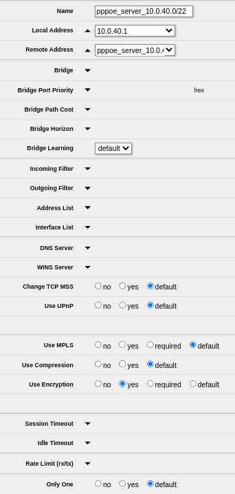

pppoe, ppp, info : using encoding - MPPE128 statefull/MPPE128 stateless
pppoe, ppp, info xxxx: CCP lost compression got out of sync: disabling compression
ppp, error, critical xxxx: Encryption got out of sync - disabling
Does anyone have any suggestions?
