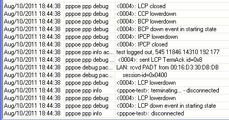

i try a server today, it can connect by wired and dial up with the pppoe directly from the laptop.
but, if i connect the server to the DSLAM, then to the ADSL modem via the telephone line.
the connection not able to establish and the mikrotik server shown me the error as the attachment.
what could be wrong?
appreciated for the advice.
thanks.
ang.
maybe in network located at side of mikrotik has another dslam or pppoe server? describe more clearly your scheme
found the issue, as reply by the mikrotik, it must in the same broadcast domain.
my problem is, the vendor have pre-configure the vlan in the DSLAM.
just removed it, then it’s works.

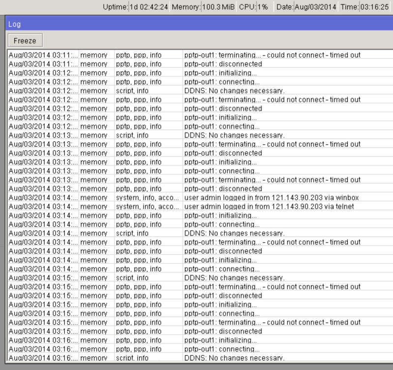

I have a same Problem in japan…
Why is each time updated a some problem…???
I try routerboot update (3.18) but, same problem…
