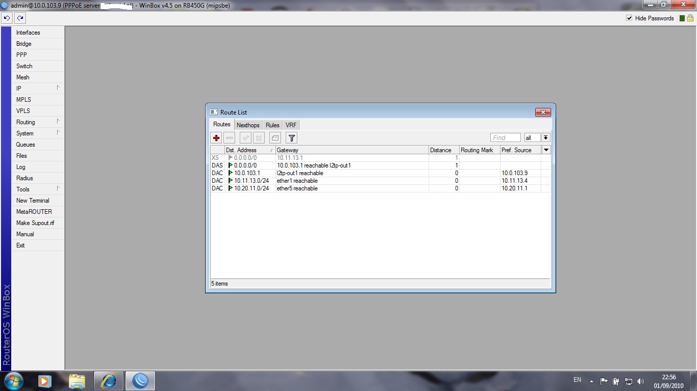

The PPPoE server could ping 10.0.103.1, but it could not ping the wan ip of the core router. I have an identical PPPoE server on the other side of town connected back to the same office and it works flawlessly. I have spent hours trying to figure it out, and I really need this to be working for the morning.

Here is my routes in the PPPoE server
