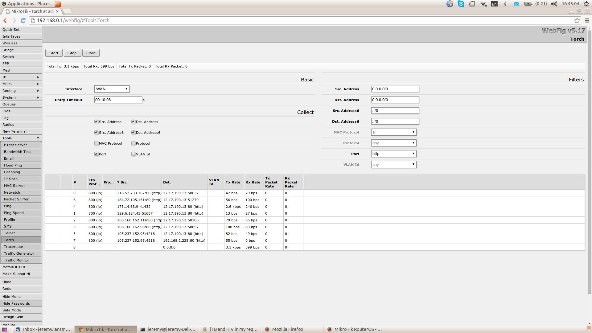

*** I could tell the request was getting onto the internet. I am in South Africa. I logged into my Alaska MT, and using torch saw the stuff come in from the MTN public IP - 105.237.152.95 I am using here in SA.
