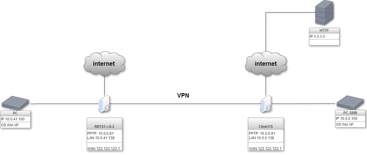

i am trying to connect to my RB153 to my workplace to get 2 things, access to our HTTP server wich accepts only connections from our ClearOS and to access the PC-SMB where we keep our documents. Both routers are connected via PPPoE with static IP’s and between them a PPTP link.
From PC(accessing whatismyip.org shows the IP of ClearOS) i can access the HTTP server but not the PC-SMB
from RB153 i can ping the PC-SMB
When connecting from PC to ClearOS directly via PPTP i can access the PC-SMB and HTTP
First i want to be access both the PC-SMB and the HTTP from PC and then i want to refine it and route only the traffic destined to them throu the PPTP connection.

i suppose there should be a route for PC to PC-SMB like
DST GATEWAY
10.0.0.0/24 10.0.0.80
and
DST GATEWAY
HTTP.IP.COM 10.0.0.80
but it does not quite work
What am i missing here?
