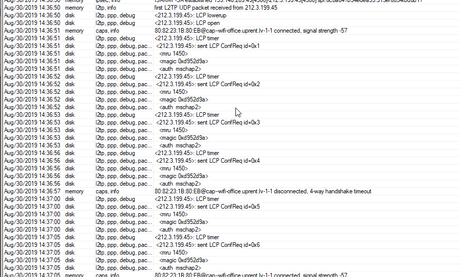

PPTP And L2tP strange case
router board hap lite when i try to make pptp from windows to mikrotik this is the print from log:
11:22:16 pptp,ppp,debug,packet <mru 1450>
11:22:16 pptp,ppp,debug,packet <magic 0x4e98063e>
11:22:17 pptp,ppp,debug,packet <4>: rcvd LCP ConfReq id=0x6
11:22:17 pptp,ppp,debug,packet <mru 1400>
11:22:17 pptp,ppp,debug,packet <magic 0x2289001e>
11:22:17 pptp,ppp,debug,packet <callback 0x06>
11:22:17 pptp,ppp,debug,packet <4>: sent LCP ConfRej id=0x6
11:22:21 pptp,ppp,debug,packet <4>: rcvd LCP ConfReq id=0x7
11:22:21 pptp,ppp,debug,packet <mru 1400>
11:22:21 pptp,ppp,debug,packet <magic 0x2289001e>
11:22:21 pptp,ppp,debug,packet <callback 0x06>
11:22:21 pptp,ppp,debug,packet <4>: sent LCP ConfRej id=0x7
11:22:25 pptp,ppp,debug,packet <4>: rcvd LCP ConfReq id=0x8
11:22:25 pptp,ppp,debug,packet <mru 1400>
11:22:25 pptp,ppp,debug,packet <magic 0x2289001e>
11:22:25 pptp,ppp,debug,packet <callback 0x06>
11:22:25 pptp,ppp,debug,packet <4>: sent LCP ConfRej id=0x8
11:22:27 pptp,ppp,debug <4>: LCP timer
11:22:27 pptp,ppp,debug,packet <4>: sent LCP ConfReq id=0x8
11:22:27 pptp,ppp,debug,packet <mru 1450>
11:22:27 pptp,ppp,debug,packet <magic 0x4e98063e>
11:22:30 pptp,ppp,debug,packet <4>: rcvd LCP ConfReq id=0x9
11:22:30 pptp,ppp,debug,packet <mru 1400>
11:22:30 pptp,ppp,debug,packet <magic 0x2289001e>
11:22:30 pptp,ppp,debug,packet <callback 0x06>
11:22:30 pptp,ppp,debug,packet <4>: sent LCP ConfRej id=0x9
11:22:33 pptp,debug,packet rcvd Call-Clear-Request from (windows real ip)
11:22:33 pptp,debug,packet call-id=52746
11:22:33 pptp,ppp,debug <4>: LCP lowerdown
11:22:33 pptp,ppp,debug <4>: LCP down event in starting state

I have similar situation, but I cant understand why one windows machine can log with same VPN username but other machine can not connect?
Log from MikroTik is at attachment.
What could be wrong at Windows machine? Both machines are Win10 with up to date updates…
Hello again, following tutorial solved the problem with MSchap2 on windows machine:
https://superuser.com/questions/1298513/l2tp-ipsec-vpn-fails-to-connect-on-windows-10-works-fine-on-ios
