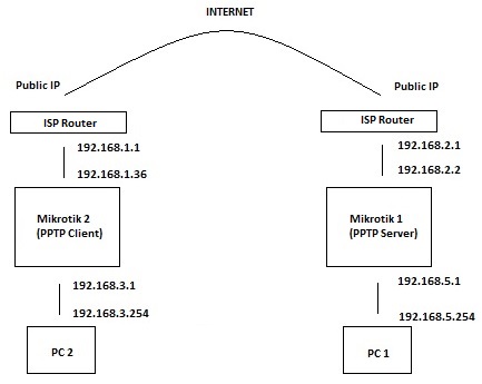

I am a newbie in MKTs and I have set up a pptp connection between 2 MKTs and it works fine.
Each MKT is behind an ISP Adsl modem-router.
I want the PC1 to be able to ping PC2, but that doesn’t work.
The only thing that works is that the MKT 1 can ping PC2 and vice versa.
I am sure the problem is in NAT configuration.
The only NAT configuration for both MKTs is the following (ether1 is the interface to the ISP Router)
add action=masquerade chain=srcnat out-interface=ether1
Can anyone help me?

please provide a new diagram and include the VPN addresses.
Also the config of both routers after obfuscating any sensitive information
