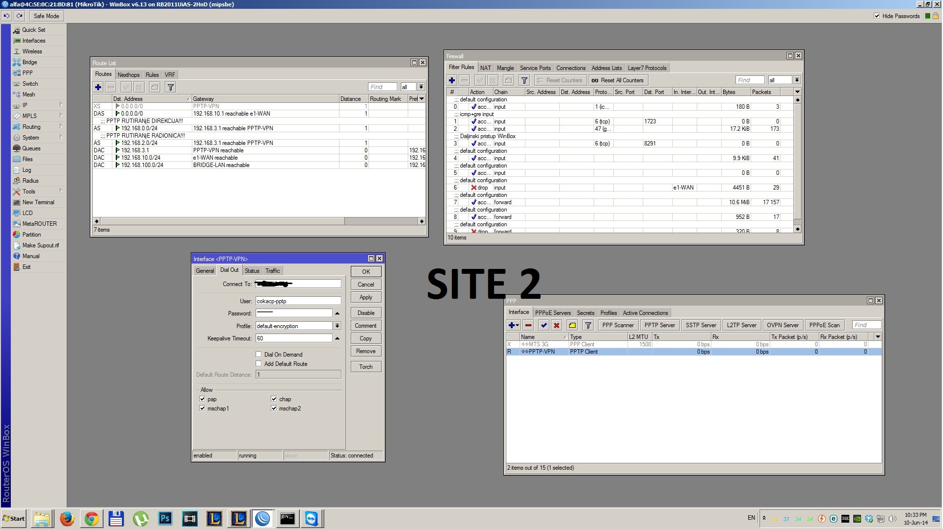

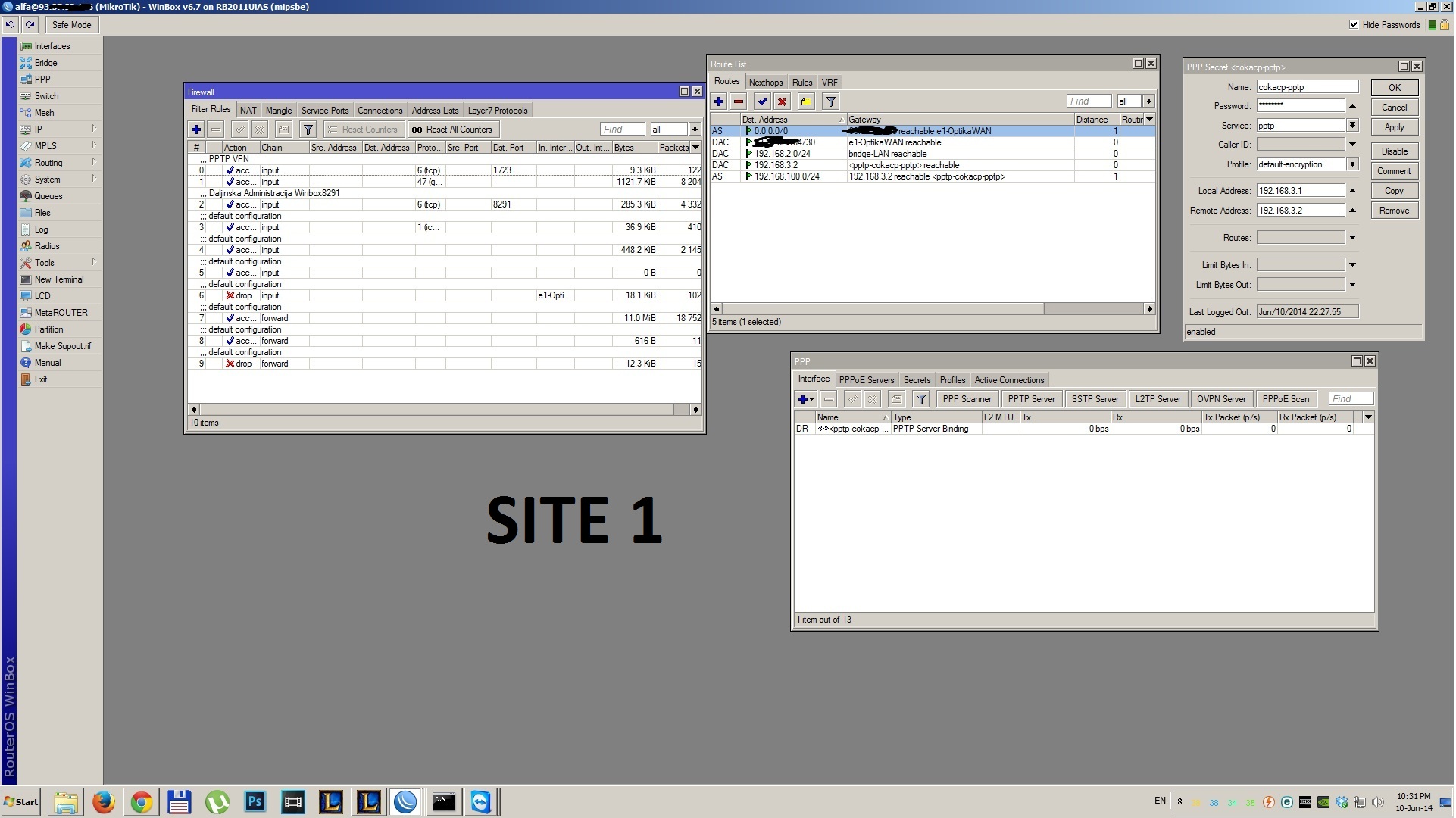

Hello guys, I successfully established site to site connection with PPTP. On Site 1 I have pptp server with lan 192.168.2.0/24 (Site 1 is also connected with IPsec tunnel to lets say site 3 with mikrotik-mikrotik, that is working fine, just for the records lan of site 3 is 192.168.0.0/24), on site 2 I have lan 192.168.100.0/24. I am able to access from site2 to whole site1 and site3, everything there is fine, but I cant access from site1/site3 to site 2 to anything else than my mikrotik which is PPTP client (so I can access 192.168.2.250 which is remote adress of site 2 router when its connected via VPN to site1), but I cant access for instance to my PC which has 192.168.100.253. Any help? suggestions ? :smiley:

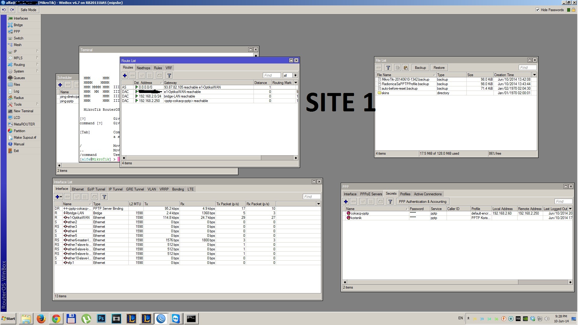

Here are Screenshots of routes from both sites. I guess site 3 is not important, right ? as its getting routed anyways from NAT

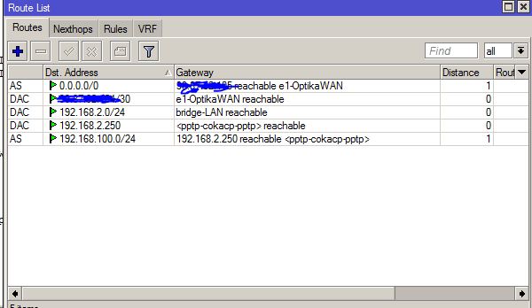

again: YOU MUST ADD THE ROUTE address=192.168.100.0/24 gateway=192.168.2.250 on site 1
I just saw you edited your post in first place, sorry. I did that on site 1 but im still not able to access anything except site’s 2 router (still same, I can access only 192.168.2.250 which is pptp remote ip of mikrotik on site2, but I cant access any pc from site2 lan like 192.168.100.x ).

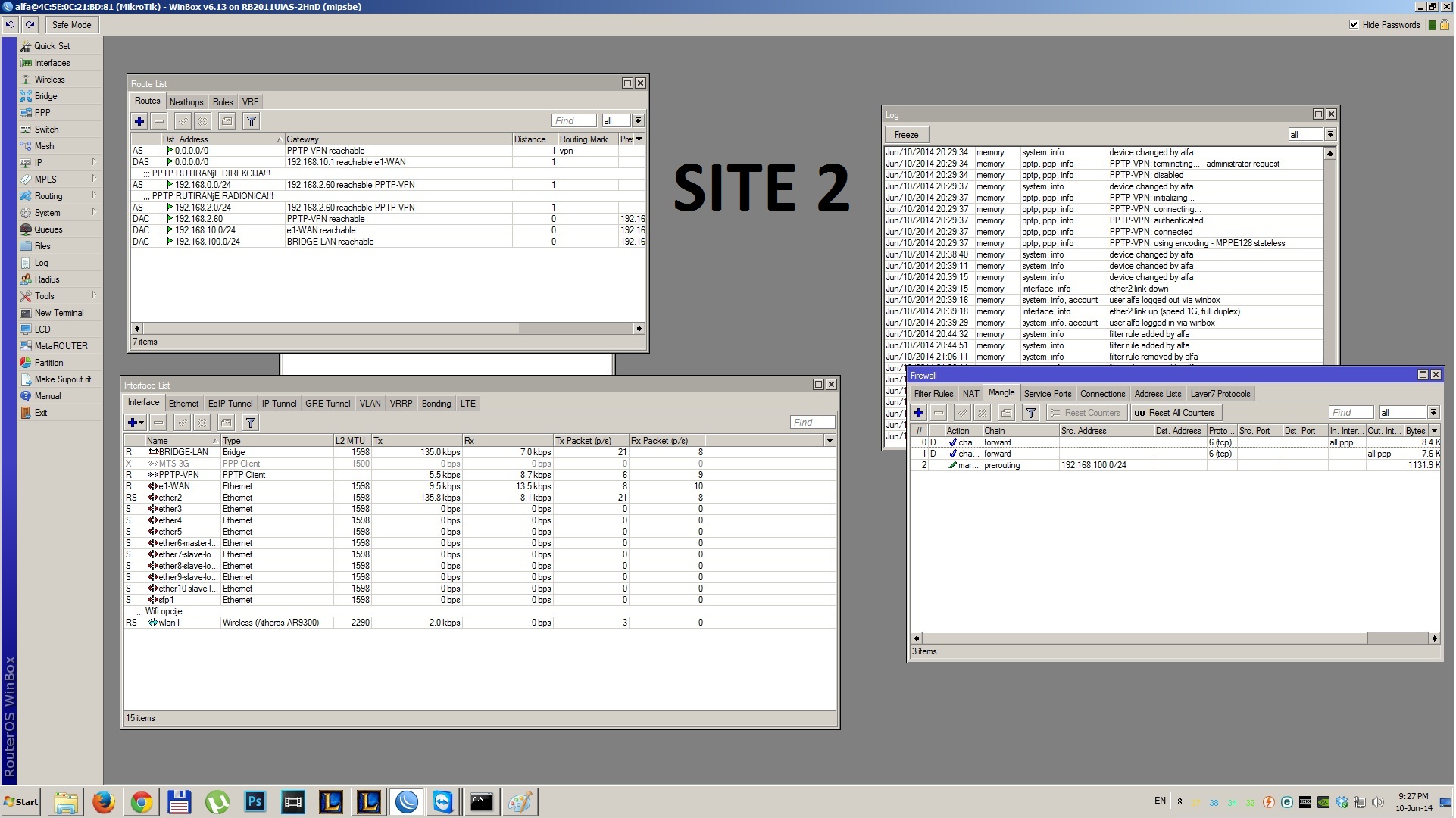

on site 2 i see mangle for mark routing, have you try to disable that?
on site 2 you must add one rule like address=192.168.2.0/24 gateway=192.168.2.60

  1. I disabled mangle mark routing and in routes route that uses mark, but still same.
  2. I already have that route, check it again on picture.
  3. I read somewhere that I should use local adress same as LAN of router :open_mouth: Anyways I changed all locals of secrets/profiles to 192.168.2.61 and in routes everything where mentioed 192.168.2.60 to 192.168.2.61, everything is still working the same. Should I try to use another subnet like you suggested ? like to set local adress of secrets/profiles to 10.10.10.1 ? And I did not get what you ment by 10.10.10.2 ? Thanks for your help, you are the best, I really need to get this fixed … :confused:
