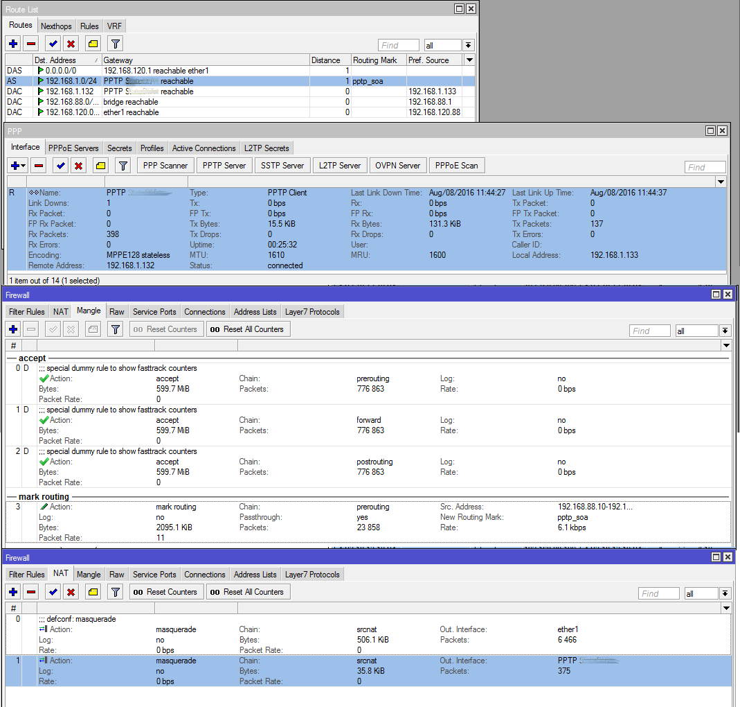

I ordered a Mikrotik device, with latest stable version of RouterOS on it.
I tried steps, as they can be found online (see resource links), but still I cannot access the LAN of the other side…
Situation:
Local LAN (192.168.88.x) → RouterOS → VPN-client —> / Internet / —> customer VPN server (pptp) → remote LAN (192.168.1.x)
Steps that I did:
  1. create a PPTP Client connection
  2. create firewall NAT masq rule for pptp connection
  3. create firewall Mangle preroute rule
  4. added a route to the remote LAN network (using routing mark)
  5. added DNS address
Result:
1- CANNOT ping from router to any ip on remote lan
2- CAN ping from local lan to any ip on the remote lan (!!)
3- CANNOT do any other protocol (FTP, HTTP, HTTPS, TELNET, RDP, SSH…) to any other ip on remote lan
→ when connecting to http,telnet,rdp … it always times out : it seems to do the initial connect + ack, and then it “stops” ?
→ ftp is even more strange: it can connect, auth, and then CD to a dir, but doing an LS, it stops somewhere in the middle of the LS output… (timing out after some time)

Attached are screenshots of current setup / config.

From which interface are you trying to ping? Are you explicitly selecting the PPTP interface when doing this ping?
So the ping reply is finding it’s way back suggesting the route setup is basically working.
Here I would look to your filter rules. I see fasttrack rules. That has a history of not playing nice in VPN scenarios. While I know this is certainly true for IPsec and as from v6.35 it is listed as supported for L2TP, I’m not sure how this currently stands for PPTP (maybe someone else could chime in here). To be sure, disable fasttrack for now until you get the basics working, then start optimising for performance. The behaviour you’re describing certainly sounds like things going wrong in the established/related department (which is usually where you will also find the fasttrack rules).
Secondly, I see you have used the quickset (defconf rules). I personally always setup the routing manually from scratch to prevent any ‘automagic’ settings setting me off on a wild-goose chase while trying to get things working. Are your forward rules correctly allowing a free flow of traffic to that remote subnet?
These are just some ideas. Use the torch on the PPTP and local interfaces to get more info on what is actually happening. Please provide an /ip firewall export to have a look at potential configuration errors. Alternatively you could just turn off all the filter rules if your situation permits for a limited testing period without firewall.
