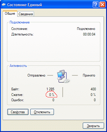

are you using Windows? check that there’s no ‘Compression’ in Connection state (Details?) of your VPN connection

have you checked ‘Compression’? can you ping VPN Client’s address from RouterOS? can you ping VPN Server’s address from client?

Compression is (none)

I meant, here:

Compression won’t work with MT - it’s a MS thing (Most Linux PPP’s only support header compression - not the same thing)… Encryption, you MUST use MSCHAPv2 authentication, and only MSCHAPv2
