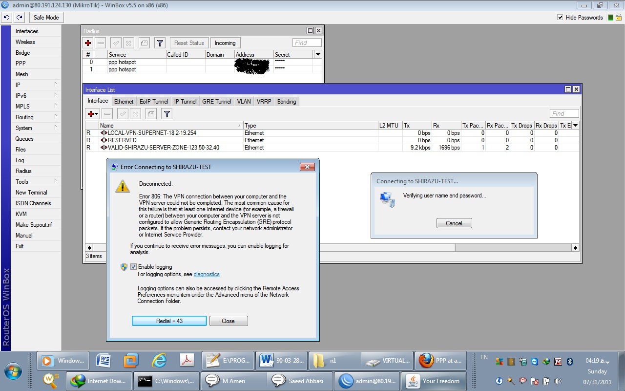

I want to set up PPTP (VPN) server on my server (Router OS for X86 ) but after configure all setting can not connect to this server and see error about GRE protocol

i use free-radius as radius accounting server and no problem with hotspot RAS

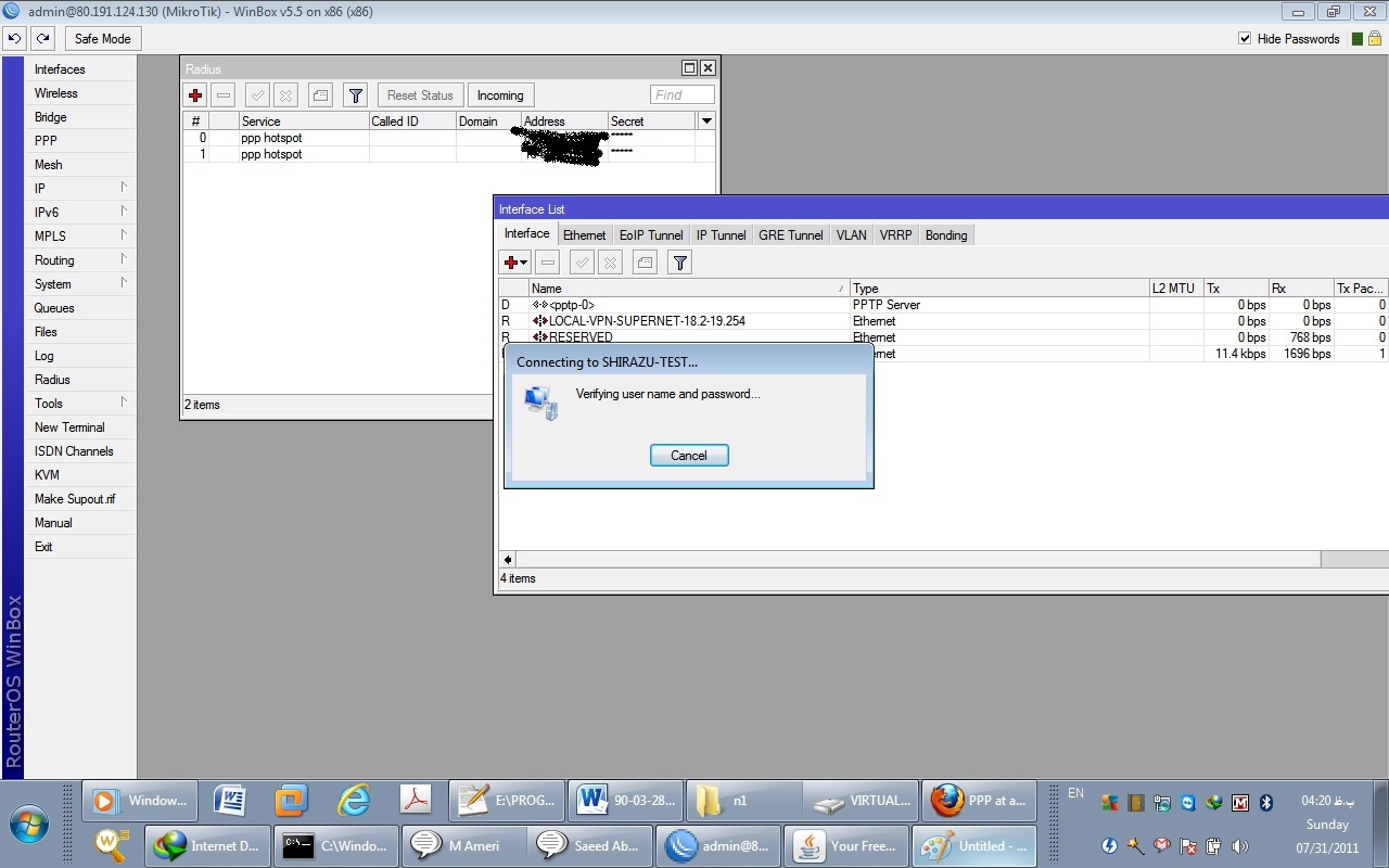

i correct all of setting and set on local accounting (secret part) but can not connect
but i see on my client can not connect to vpn server with error 806 about GRE protocol
for troubleshooting this problem i connect to server with cross-over cable "Ethernet to Ethernet"to my laptop but still have same problem
can you guide me about better configuration
