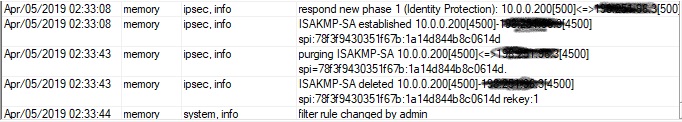

I switched to to SSTP, forwarded SSL to my MK and then allowed 443 into my MK as well. I can run torch and see the public IP of the other side hitting my MK. But it still does not connect.
I just saw that it makes it past the verifying the login, and the log on my MK here shows “TCP connections established from x.x.x.x” but then it times out on the remote computers side.

Sorry about that, I thought my web server was working properly, but I guess not. I have uploaded an attachment to show you what it is doing!

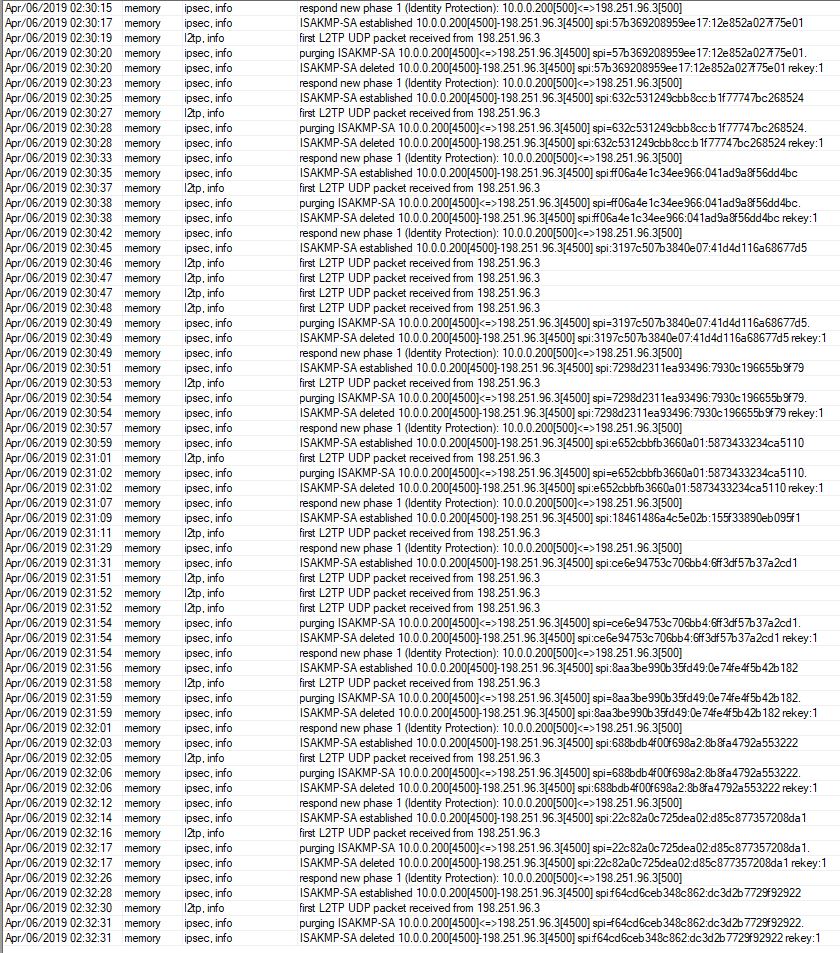

I may give that a go, for the time being, I just re integrated my asus router and put my modem in bridge mode. So im hoping my ASUS router will allow me to open up the protocol that I need for L2TP-IPSec!!
So, I have ALL ppp options enabled for passthrough on my asus router, modem is bridged, asus gets public IP. I also have all of these actions accepted on the MK firewall as well. I got you all a shot of the log as well!
