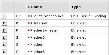

Do you have a bridge interface? or just ether2-master? if ether2-master is a port of bridge ‘bridge’ then proxy-arp should have been turned on by turning it on bridge. But if ‘bridge’ has no ports, proxy-arp would need to be enabled on ether2-master on the office side.
These are the Interfaces.

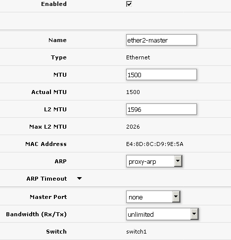

Is proxy-arp enabled on ether2-master?
Yes it is.
