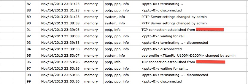

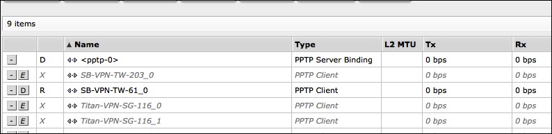

I encountered a problem, Right after I upgrade the ROS from v6.5 to v6.6 today, the PPTP connection changed to “PPTP Server Binding” (screenshot 1), Although the connection shows established but it was hang on waiting for call shown in LOG. (screenshot 2)

Only the connection will stuck on and wait for the call.
