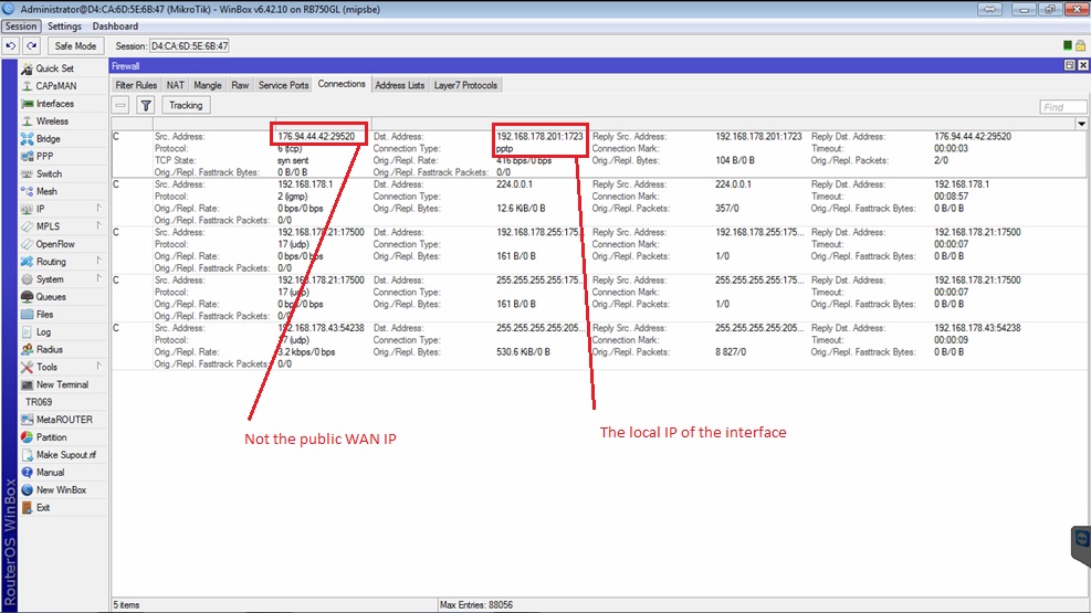

I attached a screen shot which shows the connections currently made while trying to connect from outside via VPN PPTP.
It seems that the reply isn’t send to the right destination. The destination address is totally unknown by me, maybe because it is an arp address?
Has anybody any hint to solve my problem, I am out of ideas now :frowning:
Cheers, Mike.
Ok, so far, 179.94.44.42 ist the ip which requested the vpn tunnel. This seems to be ok, but why the connection isn’t accepted by the vpn client?

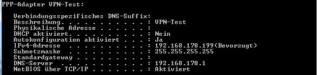

As long I try to connect via LAN (VPN server '192.168.178.201') a valid connection is done.
The right ip address was set, but no default gateway and sub net mask of 255.255.255.255 was set for this vpn connection.
Is this correct?
