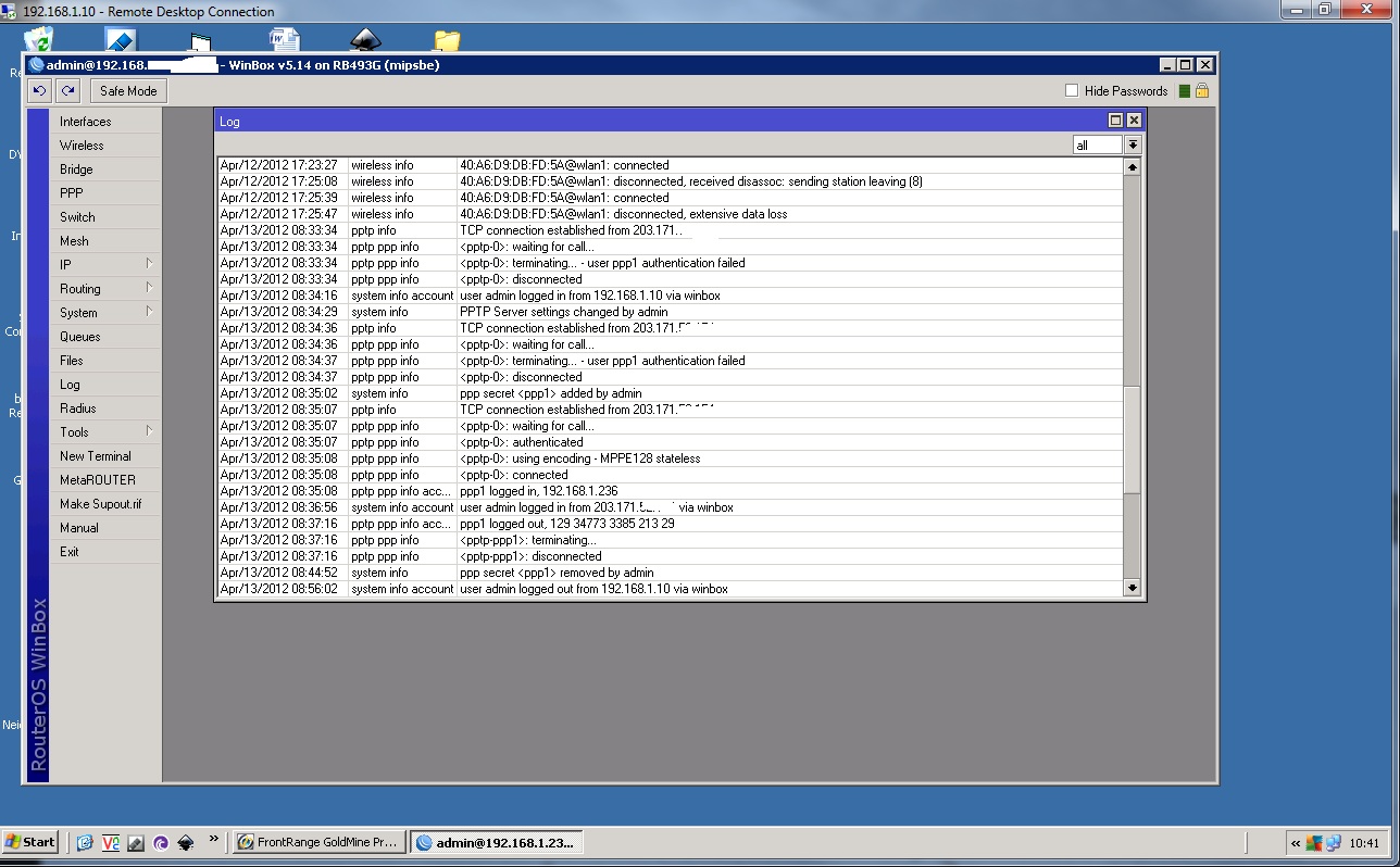

thanks for your help. does this look like i’ve enabled pptp-info logging
Sure does, and ppp, pppoe etc. :smiley:
I do not see any actual PPTP entries in the log though.
