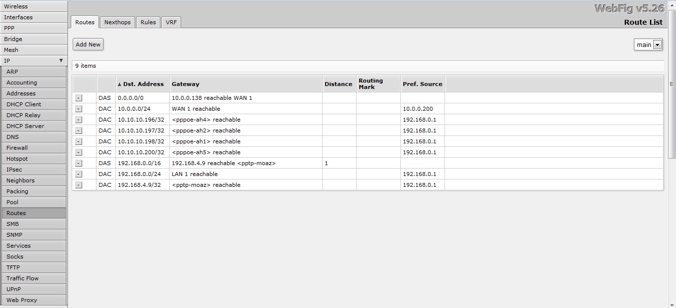

Did you add the route to the localnet in “/ppp secret”? I have multiple networks on my clients, but to access them from my VPN server, I must add the network to “routes”. For example, I have two networks on my VPN client test router. 192.168.3.1/24 and 192.168.5.1/24, so I had to add this to my entry in “/ppp secret” on the server, then disconnect and reconnect the VPN client.
/ppp secret
set 0 routes="192.168.3.0/24,192.168.5.0/24"
Check in “/ip route” on the VPN server after the reconnect to insure the new route is added as a dynamic route there.
i just did that and test it and the result is the same, no ping at Ubiqutie access points or even the mikrotik itself.
i noticed that i get subnet for my vpn connection /32 such as 255.255.255.255 !!!
Did you check the entries in “/ip route” on the server after the reconnect? Here is mine after the reconnect.
172.16.0.2/32 is the ip of the VPN client.
Note the routes for 192.168.3.0/24 and 192.168.5.0/24 have a gateway of 172.16.0.2.

yes, here is mine:
You know you will not be able to reach any 192.168.0.x ip through that VPN. That ip range is assigned to LAN 1.

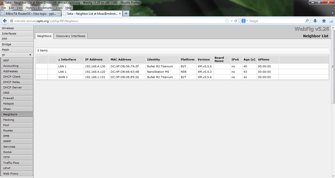

Thats why i need to access 192.168.4.x devices on the mikrotik’s lan to view it’s performance remotly as i’m there.
192.168.4.x for wireless access points and pptp clients.
192.168.0.x for static arp clients
10.10.10.x for pppoe user manager clients
So your VPN ip 192.168.4.9/32 is also in the same as one of your localnets? I don’t think that will work. Do you have a 192.168.4.0/24 localnet somewhere in one of the routers?
yes.

i changed the ip address, after pptp client connect i can ping 192.168.4.1 but i can’t ping the others on the same subnet !!!
what would be wrong now ?!
