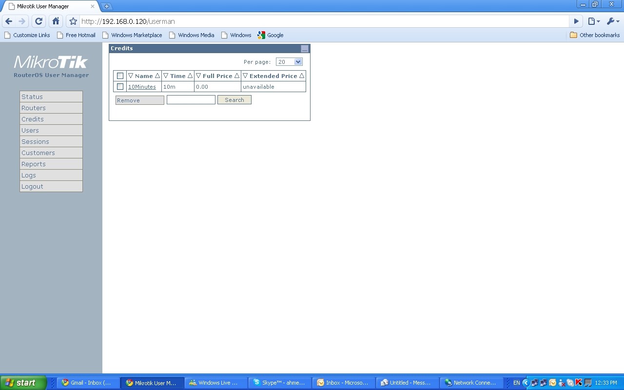

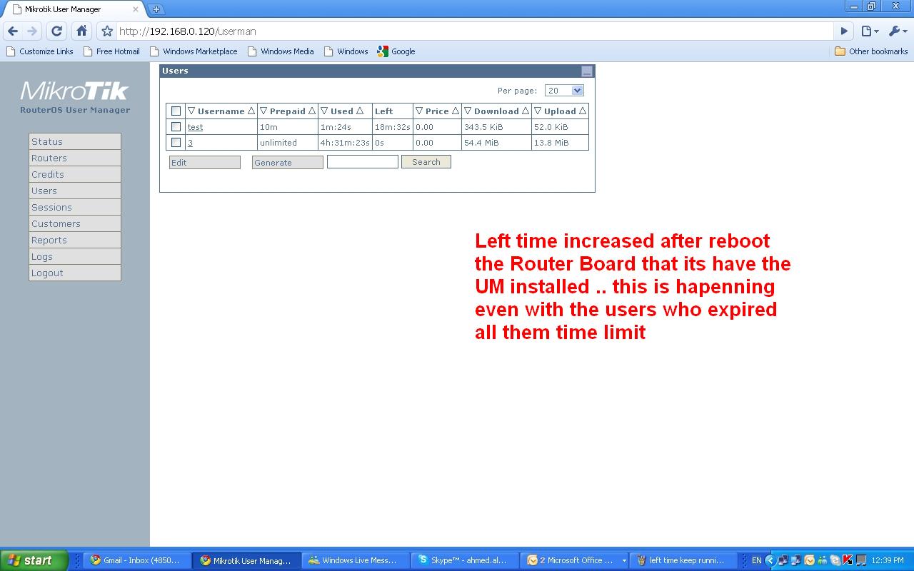

i have problem with the usermanager prepaid users , when i add new credit with specific period its working normally as it should be , but if i turn off and on my user manager Router Board , the prepaid users having anoother extra Time in the time left !! how is this ? i read all the wiki and examples and applied 100% the right config in user manager but its still same problem .
i have tried with RB433 with both OS 4.6 and 3.30 and both having same problem ..
one more thing , from the wiki i read that in v 4 its should be profile instead of credit but here i did not see that as both having same credit and there is no profile section in 4.6 UM .
Here is screen shots from my UM

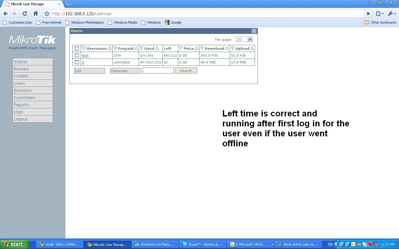

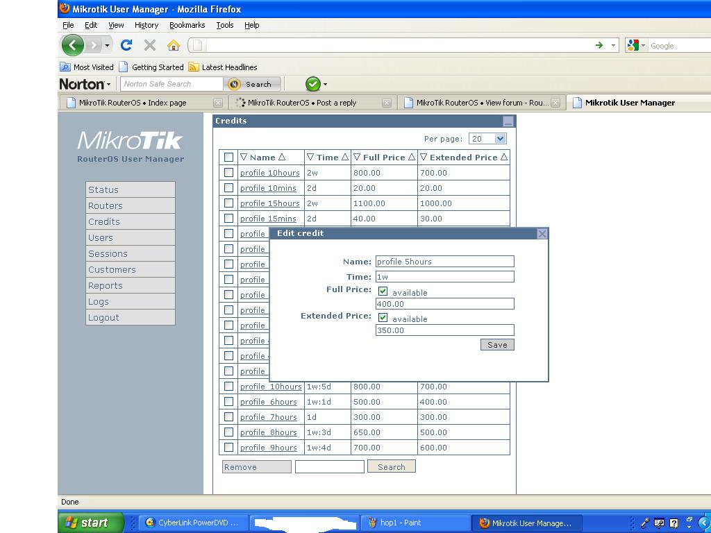

LOGIN INTO UM ADD CREDIT
NAME ANYTHING
SHOULD BE IF YOU WANT TO CREATE 18000S WHICH IS 5HRS TO LAST FOR 6DAYS
TIME: 6D IS 6DAYS
FULL PRICE: ANY
EXTENDED PRICE: ANY
SO IF YOUR USERS LOG OUT UM WILL STOP TIME SESSION FOR 6DAYS, THEN AFTER 6DAYS, CREDIT REACH
SO YOUR USERS NEED TO USE THEIR TIME BEFORE 6DAYS
OK SO SEE MY ATTACHMENT

Thanks for posting , i have contacted Mikrotik support and they informed that the issue with the old package of UM itself .. you can try it same procedure u post and see the time left for any user u add , then try to turn off and then turn on your Routerboard where the UM is installed u will see that the left time is increase .. u can also see the users already expired are able to access after this power cycle.
upgarded UM to new test package its solved this issue but still having another problem , if the time is expired and the user didn’t logged out he can use the internet and the UM didn’t deny his username and password untill he log out by himself " The user " then he can not log ing again
