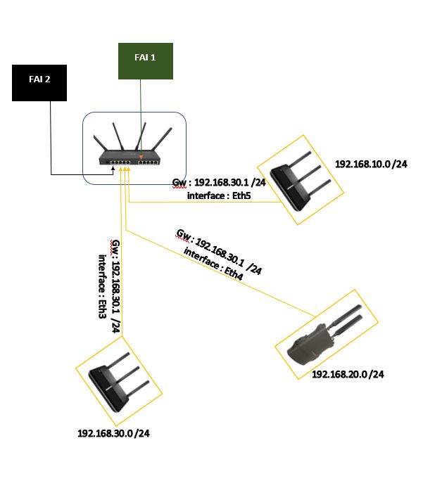

I am newly dealing with Mikrotik Staff. The one i use is the mikrotik Router rb4011igs+5hacq2hnd-in. My network Architecture is as follow :
I would like to set the followed actions:
  • 1st ACTION : PREROUTING
    I would like to route a very group of users from this network: 192.168.20.0/24 to the FAI2 (ISP2) in priority and towards the first FAI1 (ISP1) in case of the unvalability of FAI2 (ISP2).

The main purpose is to select a group of user connected to the wireless of the access point. Then, make those users specially go through my second ISP (ISP2). That is what i want to achieve. despite the actual config done on the router.
Only the selected users should take the way of the ISP2, and then if the wan port of the ISP2 is not available then ISP1 will be the way.
How I would tackle it:
conceptually the same method based on PCC and mangle rules.
Instead of assigning connection marks based on PCC classifier, you can either assign fixed IP to those specific users, or make those users connect to different SSID/VLAN (which then also will results in another subnet being used).
Whatever way you choose to be able to separate the traffic so the correct connection mark can be assigned.
Once that connect mark is set, the rest of the setup is the same as PCC.
If ISP2 is unavailable, the setup will allow to automatically move to ISP1.
Useful video for setting up PCC to be used as base.
https://www.youtube.com/watch?v=nlb7XAv57tw

As noted, its much easier to separate users by SUBNET if you can do it by port, or by SSID (wifi) if you have wifi.
Very nice approach because if you can get people to use a specific SSID, we can assign a subnet to that SSID and
the goal is accomplished. Whats nice about that approach is it gives you two possibilities.
a. all the users know how to access both SSIDs, and thus depending upon their needs they can choose which interface to use
b. users only have access to the SSID the have been given permission (ssid password) to use ( admin control ).
The advantage of subnet approach is that you dont need the complexity of mangling and simply can use routing rules!
