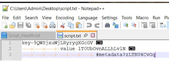

Is there a way to get that code block and save it to a file while maintaining that structure?
i’ve tried mucking around with it but the /file set seems to handle the \r\t differently to the cli.

/file add name=script.txt contents= "$k \r\t\t\t $v \r\t\t\t\t\t\t $m"
Gives me this output on the cli
key-9QWSjxuWjLRyrygXGcG value lT0UbOvnALLhLvlN #metadata?zLTRU4CvOq
But when I extract the script.txt file and open it in Notepad++ I see this.
UPDATED
Now I see. You're looking at the output. That's right. Unless you copy the text shown at CLI (which would have "resolved" the tabs by then). But in a text file, that what actually output.
The reason "columns" come from that RouterOS CLI will read the \t \r things, to control a cursor, but there no terminal to "intercept" those when writing a file, it just the raw stream (no cursor to control).
For files, you should use :serialize to=dsv delimiter="\t" <array-variable> file=myfile.txt file to output columns.

Sorry, I should have been more accurate in saying that any word editing program doesn’t handle the ā€˜columns’ that we create here in the CLI.
I think I understand why, the manual says it for creating escape sequences within the string. So when a Mikrotik device handles that, it does those escape sequences, as we programmed, but when a foreign program like Notepad++ see’s it, it just tries it’s best and ends up doing something different.
Anyhow, I’ll give the serialise command a go and see what I can make out of it.
Issue here is that when printing to console \r control characters behaves as actual carriage return (returns cursor at beginning of line) while text editors represents it as new line (Mac new line format). If text editor would show characters same as printed in console in some cases it will not display all characters and it will lose its purpose, eg. :put "a\rb" - it prints only b becase a is overwritten when cursor returns.
To get exact file prevew with fixed tabbed column spacing you need some text viewer that will treat \r same as console or use terminal to print file content.
