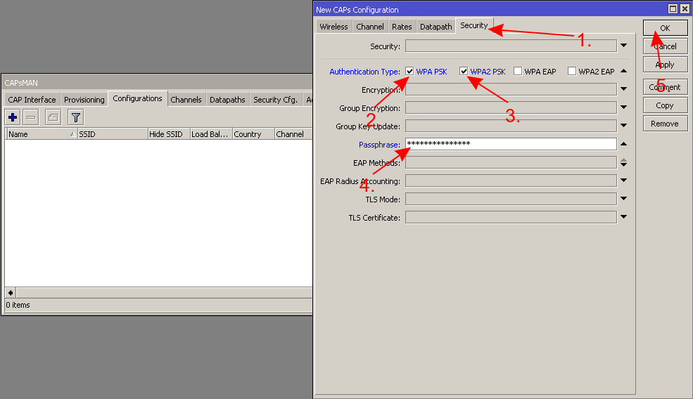

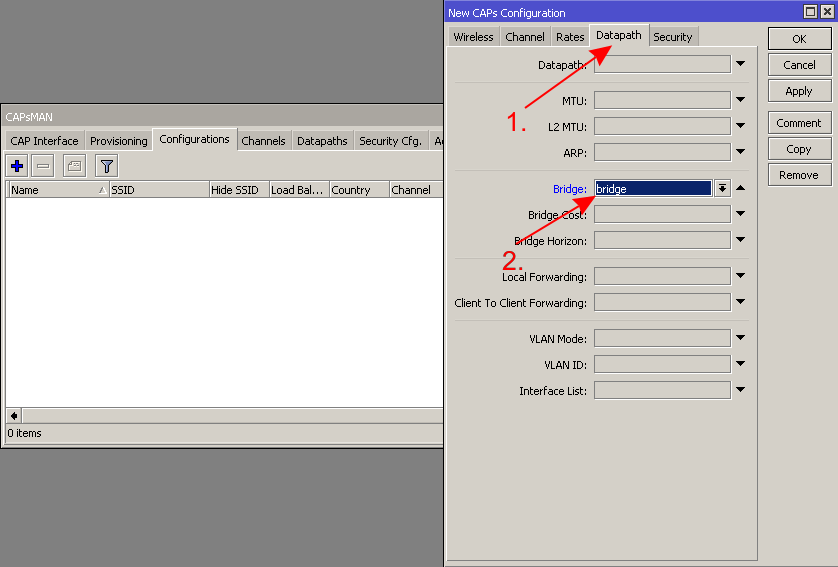

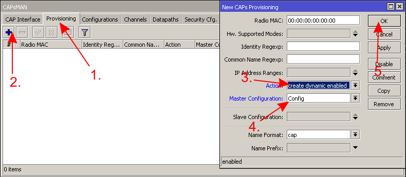

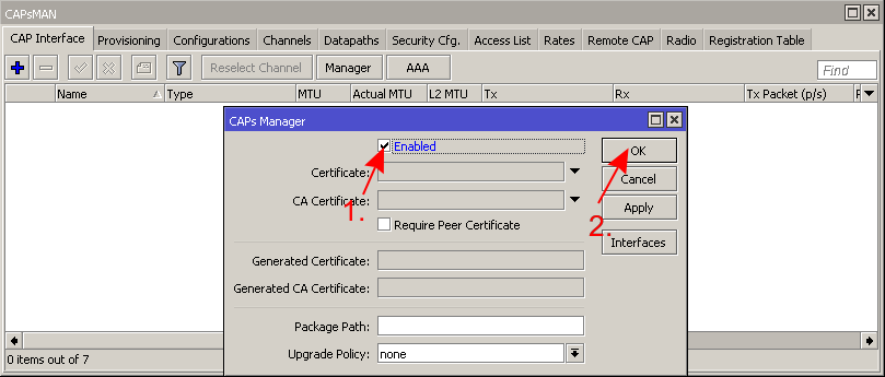

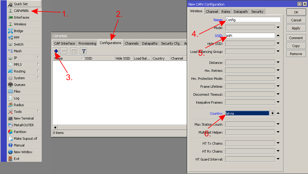

The images come from Mikrotik help pages:
they represent the basic CAPsMAN settings (and the idea is that the AP's are later connected as CAPS by connecting them via ethernet and setting them automatically in CAP mode via pressing the reset button).
Without some more descriptions of the general network and the actual configuration of one of the AP's it is difficult to understand what the issue is.
