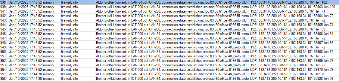

This firewall rule allows me to ping the printer from the devices located on VLAN ID10. However I am still unable to print. I tried to add the printer via the dedicated IP directly in windows (“add a printer or a scanner”) and also via the Brother software (the software can initially locate the printer, but is also unable to add it). Does anyone have an idea what I am doing wrong?
For testing purposes connect one of the devices from VLAN ID10 to the VLAN ID30 (inside the printer subnet) and then try to print. Maybe it’s not a network/firewall issue but more printer/driver thing itself.
You need a second firewall rule that also allows the traffic from IOT / Print as in interface to the out interface home. Basically the “return traffic”.
Simple way to test firewall issue, is to add a dummy accept all rule at the end (before final drop rule) which you enable only for testing purpose (maybe even log that one if traffic is not too heavy).
If it works then, you know you filter some traffic that is needed… and need to tune filter rules.

I have a similar problem with Mikrotik TB5009UPr+S+ with OS 16.2.
  • VLAN34 - Normal (192.168.34.0/24)
  • VLAN200 - IOT (192.169.200.40 Brother printer)
I did get it to work by:
  1. Having the printer reside in the VL34 and install it with the Brother full driver and utilities EXE. The printer was found automatically and installed successfully.
  2. Put printer into the IOT vlan
  3. Static DHCP entry for printer inside to IOT VLAN set to 192.168.200.40
  4. Setting firewall rules as follows:
add action=accept chain=forward comment="ALLOW LAN34 to Brother Printer - ICMP" dst-address=192.168.200.40 protocol=icmp src-address-list=ADR_LST-LAN34
add action=accept chain=forward comment="ALLOW Brother Printer to LAN34 - ICMP" dst-address-list=ADR_LST-LAN34 protocol=icmp src-address=192.168.200.40
add action=accept chain=forward comment="ALLOW LAN34 to Brother Printer - TCP" dst-address=192.168.200.40 dst-port=137,161,515,54921 log=yes log-prefix=LAN34-Print-TCP protocol=tcp src-address-list=\
    ADR_LST-LAN34
add action=accept chain=forward comment="ALLOW LAN34 to Brother Printer - UDP" dst-address=192.168.200.40 dst-port=137,161,515,54925 log=yes log-prefix=LAN34-Print-UDP protocol=udp src-address-list=\
    ADR_LST-LAN34
add action=accept chain=forward comment="ALLOW Brother Printer to LAN34 - TCP" dst-address-list=ADR_LST-LAN34 log=yes log-prefix=Print-34-TCP protocol=tcp src-address=192.168.200.40 src-port=\
    515,54921
add action=accept chain=forward comment="ALLOW Brother Printer to LAN34 - UDP" dst-address-list=ADR_LST-LAN34 log=yes log-prefix=Print-34-UDP protocol=udp src-address=192.168.200.40 src-port=\
    137,161,54925
Note, that I even had to allow ICMP both ways so I can ping it. I thought that allowing the VLAN34->Printer ICMP would be enough. After I added the return ICMP Rule Printer->VLAN34 the ping started to work and both rules incremented their packet and byte counters. Weird…
Now I wanted to make everything from scratch again. I reinstalled my laptop to Win11 24H2, upgraded Brother firmware. I thought that the printer installation will be easy given all the FW rules were in place. But no. The automatic search feature in the Brother Full driver did not found the printer (I expected that cause they were not in the same broadcast domain). After putting the IP statically - printer was found immediately but installation failed. Even adding a FORWARD rule of allowing ALL from VLAN34->Printer and vice versa ALL from Printer->VLAN34 did not help.
When I tried to install the printer manually inside Windows, that worked, but scanner was always showing an error. Once I put the printer back to VLAN34 - install went smooth and functionality was 100%. Now I am going to add rules:
  • forward ANY → 192.168.200.40
  • forward 192.168.200.40 → ANY
to see, if some weird port is being hit. Will get you posted.
I suspect their full driver/app it’s using HTTP/S (443) or some additional to get info. But allowing ALL should work, you can also add a log=yes to rule to see what ports were actually used.
If you want discovery to work, you can likely use in the /ip/dns’s mdns-repeater-iface= using your IOT and main VLANs (and allow udp/5353 for mDNS in firewall too).
By having following two lines on the first two FORWARD position of the firewall rule-set:
add action=accept chain=forward comment="ALLOW LAN34 to Brother Printer - ALL" dst-address=192.168.200.40 log=yes log-prefix=ALL->Brother
add action=accept chain=forward comment="ALLOW Brother Printer to ALL" log=yes log-prefix=Brother->ALL src-address=192.168.200.40
.. I was able to find the printer manually in the Brother install wizard:
.. with following FW log outputted:
… i got an immediate Error saying “The installer has detected a connection problem between your computer and the Brother MFC / Printer.”.
.. without having any relevant firewall log being added. It appears to me like it would use some broadcast-type communication before executing the printer installation, which does not hit any forward rules.
Any ideas? :slight_smile:
