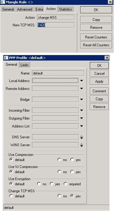

This mentions 3.30 having a bug with dynamic mss rules… i havent validated it, but it sounds like what many people experience in many versions:
http://forum.mikrotik.com/t/pppoe-mss-correction-bug-in-3-30/31576/1
search the forums for ‘tcp mss’ and you will find lots of examples. not sure if this is your problem, but its where i would start.
also, in your mangle chain are you seeing the dynamically added ‘change mss’ rules when there is a ppp connected? you should. look at that rule and post it here, maybe we can see if its not correct.
Also, I wonder something … those dynamic rules get placed at the end of the forward chain automatically. If you have QoS and packet marking rules, and you don’t passthru, I assume these are no longer being run?
Here is a screen shot of the settings. Is this what you were looking for? Should the change mss rule be changed to no?
thank you.
