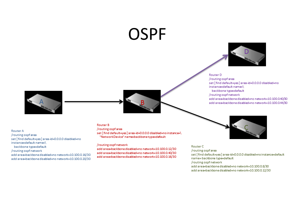

Prioritise ospf routing
I want to route ospf traffic to router D and if this router fails then to route to Router C
Router A
/routing ospf area
set [ find default=yes ] area-id=0.0.0.0 disabled=no instance=default name=backbone type=default
/routing ospf network
add area=backbone disabled=no network=10.100.0.16/30
add area=backbone disabled=no network=10.100.0.20/30
Router B
/routing ospf area
set [ find default=yes ] area-id=0.0.0.0 disabled=no instance=“NetworkDevice” name=backbone type=default
add area=backbone disabled=no network=10.100.0.12/30
add area=backbone disabled=no network=10.100.0.40/30
Router C
/routing ospf area
set [ find default=yes ] area-id=0.0.0.0 disabled=no instance=default name= backbone type=default
add area=backbone disabled=no network=10.100.0.8/30
Router D
/routing ospf area
add area=backbone disabled=no network=10.100.0.44/30
It’s pretty simple.
You only need to put a higher cost on the OSPF INTERFACE that connects to Router C on the OSPF interface settings in ROUTER B.
For instance, change from default 10 to 20.
This should do the trick.
Thanks for the reply but could I have a example of this please?
At present the ospf interface has dynamic entries, do i need to make these static?
/routing ospf interface> print
Flags: X - disabled, I - inactive, D - dynamic, P - passive
INTERFACE COST PRIORITY NETWORK-TYPE AUTHENTICATION AUTHENTICATION-KEY
0 D ether1 10 1 broadcast none
1 D ether2 10 1 broadcast none
2 D ether2 10 1 broadcast none
Yes! Make the entry static and set the Cost.
