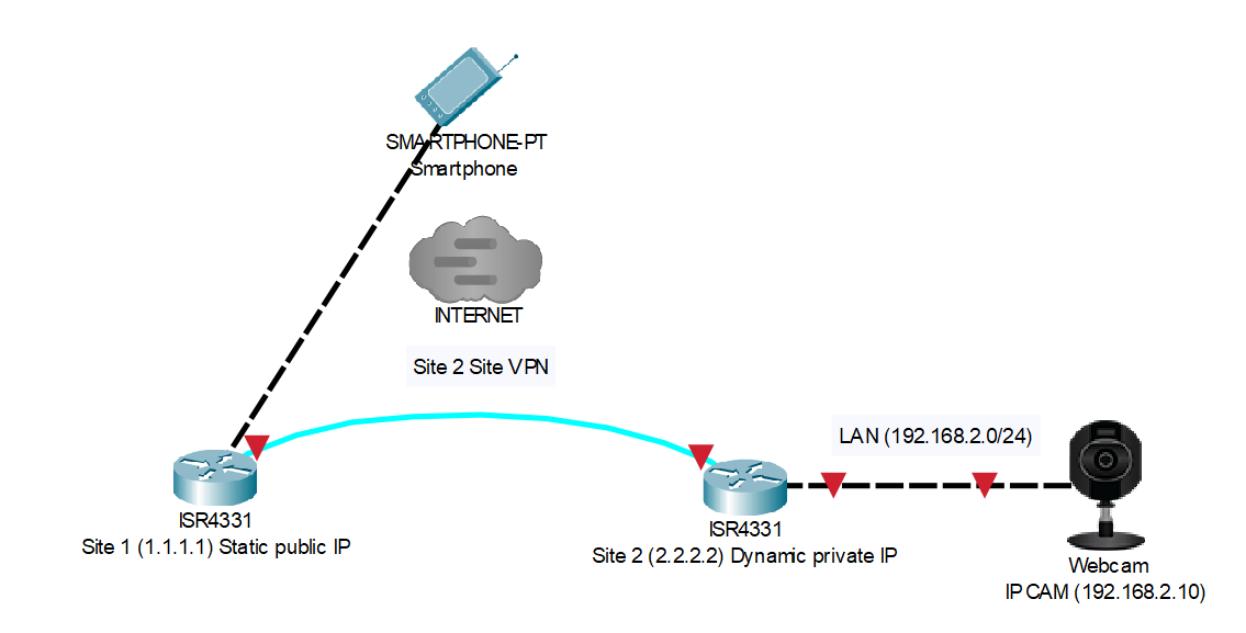

Hello everyone.
This is my problem:
I have two sites:
  • site 1 with static public IP (RB1100AHX2)
  • site 2 with dynamic private IP (NATted) (hAP mini)
In site 2 I have an IPCAM that I would like to reach from the internet through my smartphone but unfortunately site 2 has a private IP address.
Site 1 instead has a static public IP address, so I was thinking of creating a VPN between site 1 and site 2, using site 1 as a VPN server and site 2 as a VPN client.
After creating the VPN with the correct rules, do you think it would be possible to reach site 2 from the internet through site 1?
