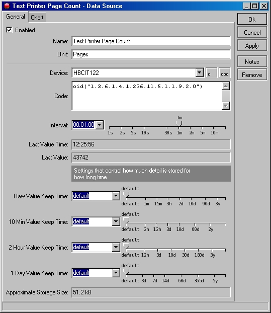

First off you will need to find the correct SNMP OID for the value you are after. As an example we have Samsung printers here on site and the total page count is the following OID.. 1.3.6.1.4.1.236.11.5.1.1.9.2.0. Samsung MiBs are not very good so I had to do an SNMPwalk through my printer and find the value that matched with the output from the printer’s counter info page.
Once you have the correct OID you can then create a chart to graph the value, or create a probe to set a threshold so once a value is hit you will be alerted that teh threshold has exceeded.
To creaet the graph, go to Graphs and then add a new Data Source like below…
In the code window replace the OID with the OID that you have retreived for your printer’s total page count. This will now graph on a chart.
To setup the probe dothe following…
Go to Probes and create a new probe like below…
You can then set a threshold value so once it is exceeded you will be notified that the threshold has been passed once you setup the notificatin for the probe.
Add the probe to the printer device and assign a notificatin to the probe so you will be alerted by a method you specify, i.e. email, beep, popup.

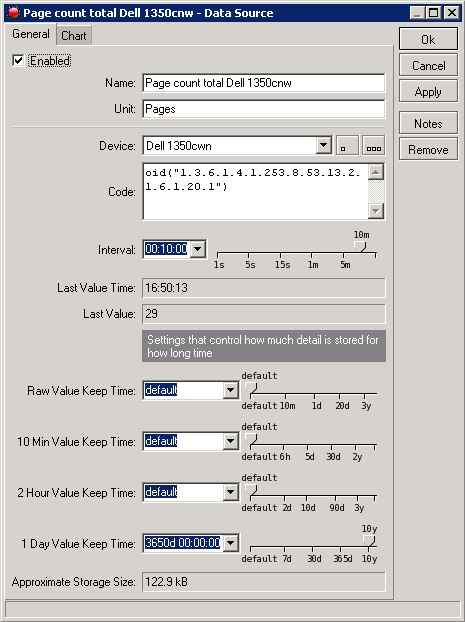

Many thanks to you chrisd13 for this good topic !
I’ve searched for the good oids in the printers with a free software named FreeSnmp from NsaSoft and found page count starting here 1.3.6.1.4.1.367.3.2.1.2.19.5.1.9.1 (for NRG MPC 3500) and here 1.3.6.1.4.1.367.3.2.1.2.19.5.1.9.1 for Dell 1350cnw.
I’m very new to Dude and Snmp but it’s really useful.
It works fine !
Here is a print screen of my probe for page count for DELL 1350cnw printer
Best regards.
