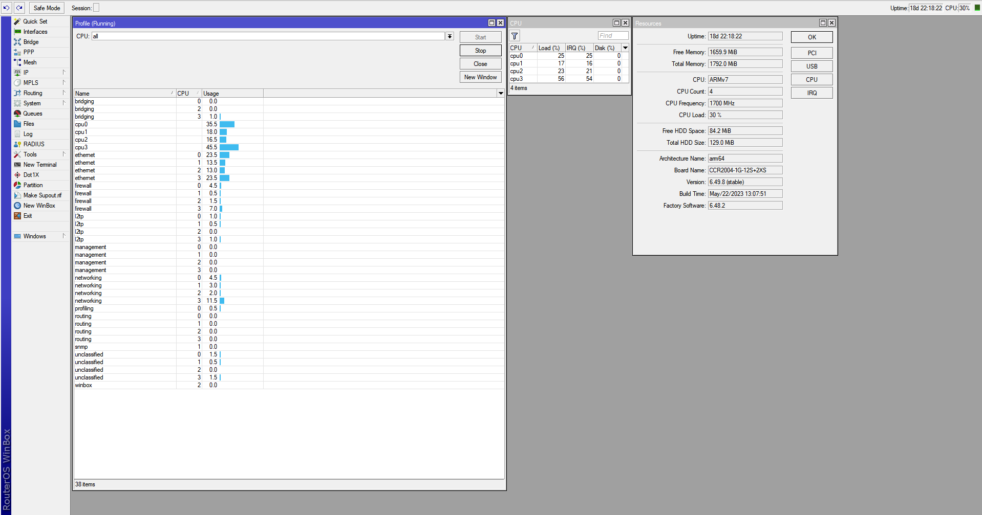

When working with the CCR2004 router, I encountered the following problem, an abnormally large and uneven load on the processor cores.
Information about the router is on the first screenshot.

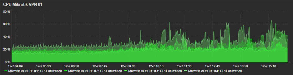

An uneven load of processor cores was noticed (screenshots at the very beginning) at peak moments, the load is 1.2GB
