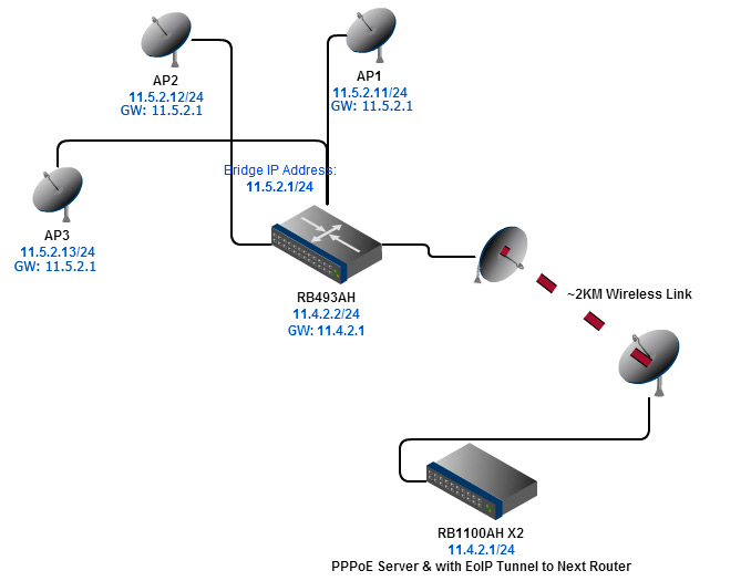

I have problem on connecting to My AP’s (AP1,2,3) on RB493 with an EoIP Tunnel from my office on RB1100AH . (see below image scenario)
I want can connect to AP1,2,3 from RB1100AH (Accessible from Main Router) … EoIP Tunnel and PPPoE Server is OK and Clients can Connect to internet via AP1,2,3 With PPPoE Connection .

My Problem is , I can’t see the AP1,2,3 from RB1100AH -with no any firewall- (Can’t ping , Ping from 1100 to 493AH is OK and 493AH to AP’s is Ok too)
