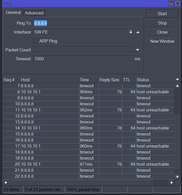

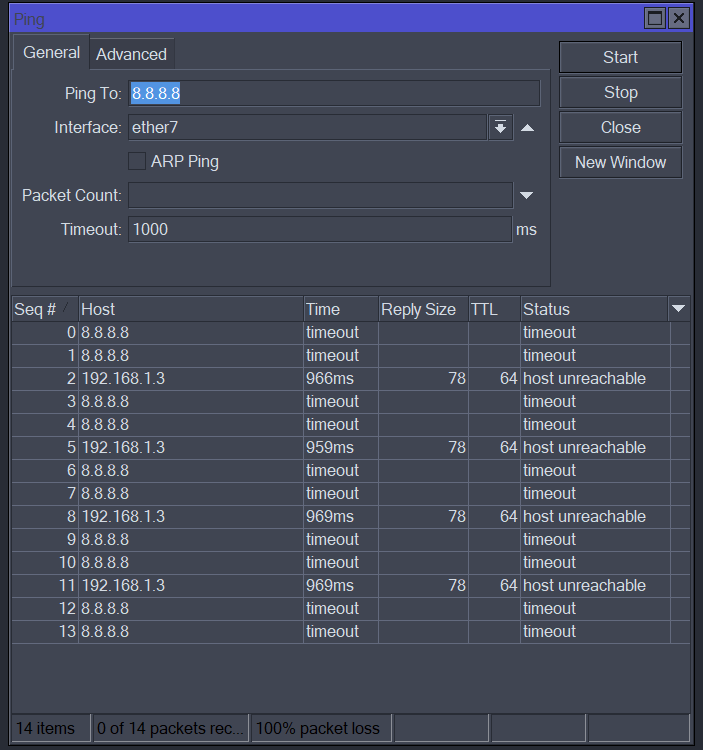

recently i bought a 2011 router , and now i have two internet !
1-come from PPOE connection trough ether 6
2-come from ADSL router from Ether 7
so now i have two bridge 1[GE-sW](allGigabite Ethernets) 2[FE-sW](allFastEthernet Except ether 6(for ppoe) &ether 7 (for adsl)
the main problem is i want to have mangle role and when i chose that mangle (enable that mangle and disable other ones)my whole internet goes from that route i configure for that mangle (each mangle i set for each internet )
Problem is mangle for PPOE and PPTP tunnels are work perfectly but mangle for Ether 7(my Adsl) not working

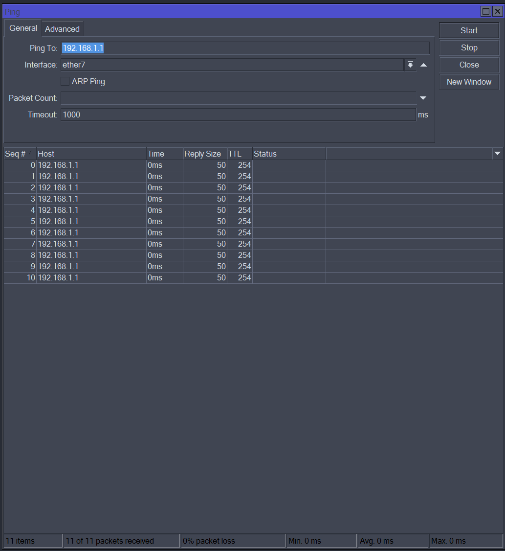

and as my second problem (it’s almost a question) Why i can’t ping my internet or an address from my bridge or any port of bridge (master or slave)doesn’t matter
also i have access to my router via ether 7(also that adsl have internet ) but i show the result above
thanks for Helping me
