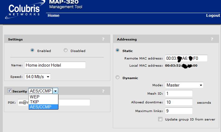

Colubris can make static links with remotes mac addresses and at the same time work as a AP for clients.

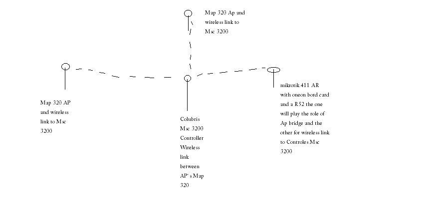

My plan

This is how colubris makes a static link using remote mac and if u want a security

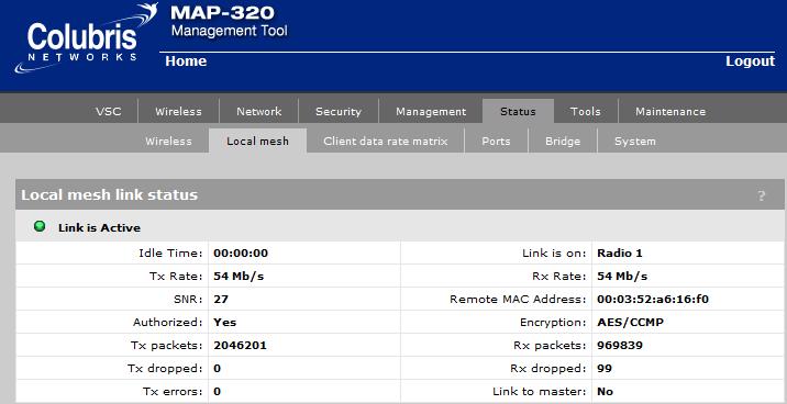

And here u can check the status if the link is up and running
