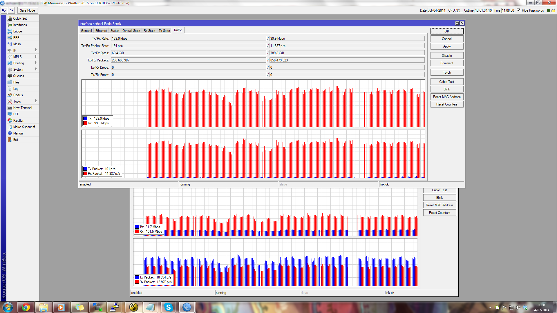

My two links its getting this gaps in traffic on the same time, when i get this, the interet access freezes, than comes up again.

See in image attatch what im talking about.

the session stays, only the traffic goes down, as i show in the image.
They are 2 BGP sessions, the trafffic goes down in both, in the same time.
