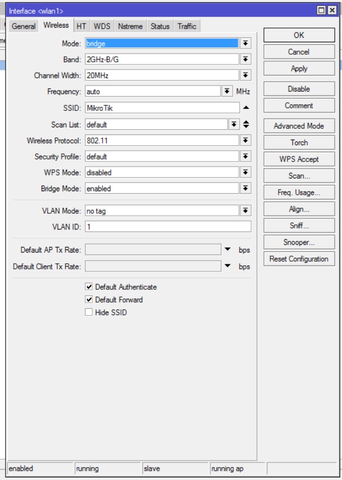

I’ve bought a mikrotik groove 52hpn with a L3 licence,
The idea is to create a outdoor ap, no dhcp server, just bridge to my homegateway.
I cant get it working with my notebook and smartphones at same time, if i change band , notebook is working but phone no, and if i change to other band works notebook and doesnt work phone
with this configuration my phone is working but not notebook.
Mode has to be ap-bridge. Band chios bgn channel width 40mhz

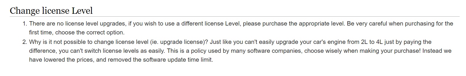

Level 3 license dont let me configure ap bridge,…
You need to upgrade the license to Level 4.
Its possible to upgrade license level?
in wiki site appears this
i dont know what to do…
if i buy another key its just upgrade ?
http://wiki.mikrotik.com/wiki/Manual:Purchasing_a_License_for_RouterOS
http://wiki.mikrotik.com/wiki/Manual:License
Problem solved, i’ve just get a L4 license and its working as i want,
Thanks for the help.
Glad it’s working. Take care of it - the license is non-transferable.
