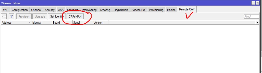

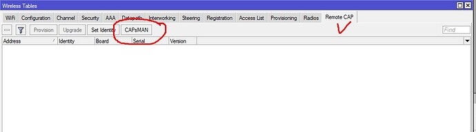

You are very welcome, glad it is working!
There she is
ok - thx for that - looks like I’m getting blind on my old days :wink:
