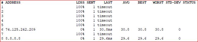

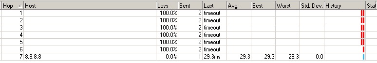

For a few days we started having problems only when we do a Trace route, we only see the destination,
IMAGE 1).
Our supplier assures us that everything is well on your side. We review everything, and it is only with which we have this problem, since they trace them towards any internal destiny they work.
Our question is that this started when we changed a Ubiquiti EdgeSwitch XG 16 ports switch to the new CRS317-1G-16S +.
We are with SWOS 2.9 only Vlan was configured, there is nothing extra, who proves to give us an idea of ​​what may be happening?
As you can see in the image we have to specify max-hops = 10 since by default it brings 5 ​​and does not reach anywhere. this is normal?
