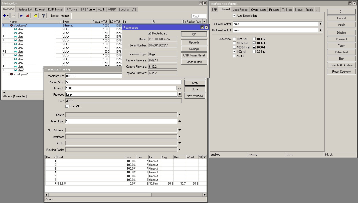

Since we installed a CRS-317 we have a problem, every trace route that passes through it does not show the jumps.
Example from a Router connected to our provider directly, all jumps are viewed correctly.
Issue:
If we make a trace from the router (a) to 8.8.8.8 (internet) connected as explained below, the trace only shows the destination 8.8.8.8 (see image)
router (a) CCR-1036-8G-2S <-----> CRS-317 <------> (b) CCR-1036-8G-2S <----> Provider (intrernet)
More details:
The switch CRS-317 has in automatic MODE 2 cables DAC reaching Negotiation of 10G in both router. Ping in both directions works OK, speedtest works perfect more than 8Gbps between both routers, there are no FILTER / NAT / MANGLE firewall rules that can interfere.
If you can give me an idea of where the problem is, I thank you.
