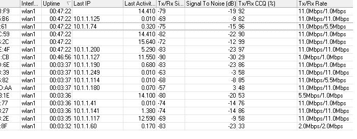

Picture from Metal
I would say this is normal on your setup… as far as I understood you have a AP ( RB Metal2) providing connectivity to PCs, laptops and all sort of other hand held devices…
is this the case?
Steven

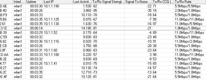

after 47 min some client access disconnected and others still connected
