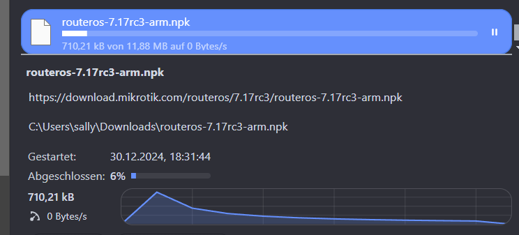

my mikrotik hAP ax² is behind a fritzbox cable and works generally fine. I can download files and watch videos, with no problems, at a normal speed. But when I try to download a file from download.mikrotik.com (behind the hAP ax²) it slows down and stops the download, even if it is a tiny file. Behind the fritzbox it works fine.
In the screenshot, you can see the behaviour. The download speed starts good but is quick slowing down until it goes to zero and the download fails.
I think the firewall rules are fine because other files, even bigger, are working and I have more or less the default/factory firewall rules.
I am on RouterOS 7.16.2
Any hints to help me?

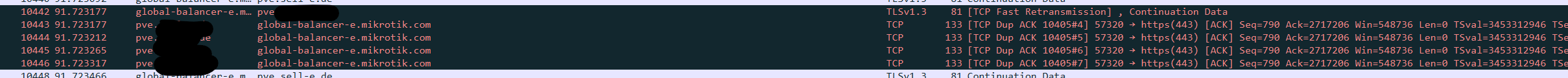

In a trace i found a lot of retransmits and duplicated ack. So its clear that there is a problem, but i can’t find the reason why.
I cannot spot anything wrong, even anything too unusual (the order of firewall rules in ipv4 firewall filter is not optimal but neither is it wrong) in the configuration; the sniffing is a good idea but you should do it on the Mikrotik itself without filtering by interface, only by the remote address. The goal is to see whether there is some issue on the Mikrotik itself and the packet doesn’t make it from WAN to LAN or whether interworking between Mikrotik and Friztbox is not OK. Could it be that you have set the MTU of Fritzbox LAN to be higher than the one of Mikrotik’s WAN (which is the default 1500)?
When sniffing without filtering on interface, the TCP dissector of Wireshark gets confused so don’t jump to conclusions, just check whether there are packets whose dst-mac-address is the one of ether1 that have no “twins” whose src-mac-address is the one of bridge-LAN. Of course, if the Fritzbox supports sniffing, it would be ideal to have sniffs from the same attempt from both devices.

I will investigate further, although I found a solution (hopefully it will stay working). I changed the uplink port on the fritz box to LAN3 and all worked fine, changing back to LAN4 the error was there again. Setting LAN4 on the fritz box to Guest-Mode and it worked.
I am not sure what is going on, I will take a look next year :wink:
Thanx for the support.
