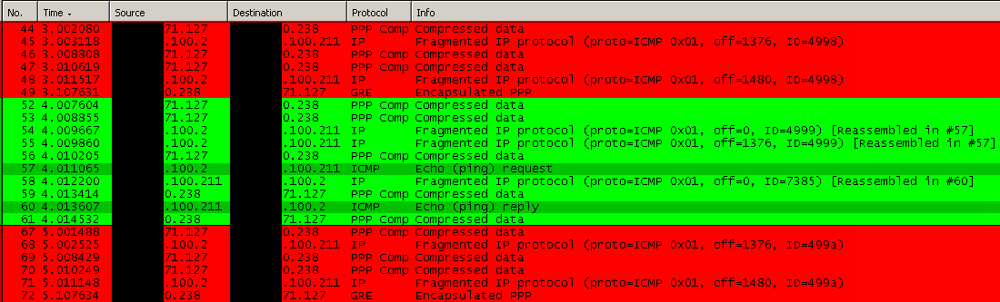

I startet sniffer on the malfunc tik.
It looks like, that when a paket is too large, it will be fragemented (thats ok)
and most of the time, the smaller paket with “fragment number 2”
will be received before “paket with fragment 1” and Mikrotik cant handle this.
On the snif you can see, that both GRE pakets from the pptp tunnel are received, but in the tunnel
mikrotik only shows the 2nd fragment:
linux-in-vpn# ping -M want -c 9 -s 1840 -w 10 vpn.tik.xxx.211

lan mtu=1500, pptp tunnel mtu set to 1400 → 3 fragments in GRE
edit: pcap on mikrotik → wireshark:
gre (ppp comp):
bad ping:
Frame 44 ttl 247 Sequence number: 1159229 (182 bytes on wire, 182 bytes captured)
Frame 46 ttl 247 Sequence number: 1159228 (1454 bytes on wire, 1454 bytes captured)
Frame 47 ttl 247 Sequence number: 1159230 (446 bytes on wire, 446 bytes captured)
good ping:
Frame 52 ttl 247 Sequence number: 1159231 (1454 bytes on wire, 1454 bytes captured)
Frame 53 ttl 247 Sequence number: 1159232 (182 bytes on wire, 182 bytes captured)
Frame 56 ttl 247 Sequence number: 1159233 (446 bytes on wire, 446 bytes captured)
IP (icmp ping):
bad ping:
Frame 45 Total Length: 124 Time to live: 59 Fragment offset: 1376
Frame 48 Total Length: 388 Time to live: 59 Fragment offset: 1480
good ping:
Frame 54 Total Length: 1396 Time to live: 59 Fragment offset: 0
Frame 55 Total Length: 124 Time to live: 59 Fragment offset: 1376
Frame 57 Total Length: 388 Time to live: 59 Fragment offset: 1480
http://en.wikipedia.org/wiki/Generic_Routing_Encapsulation#Packet_header
Sequence Number present (capital S), 1-bit
If set then the Sequence Number field is present and contains valid information.
Sequence Number, 32 bits
Contains a number which is inserted by the encapsulator. It may be used by the receiver to establish the order in which packets have been transmitted from the encapsulator to the receiver.
pcap dump says bit=1 and the sequency number as shown.
so imho mikrotik should be able to rearrange the pakets correctly

because this dsl sends 97% out of order (smaller packets receive earlier than bigger ones) I would like to know if it would be possible to implement “reordering by receiver” instead of “discarding”?
